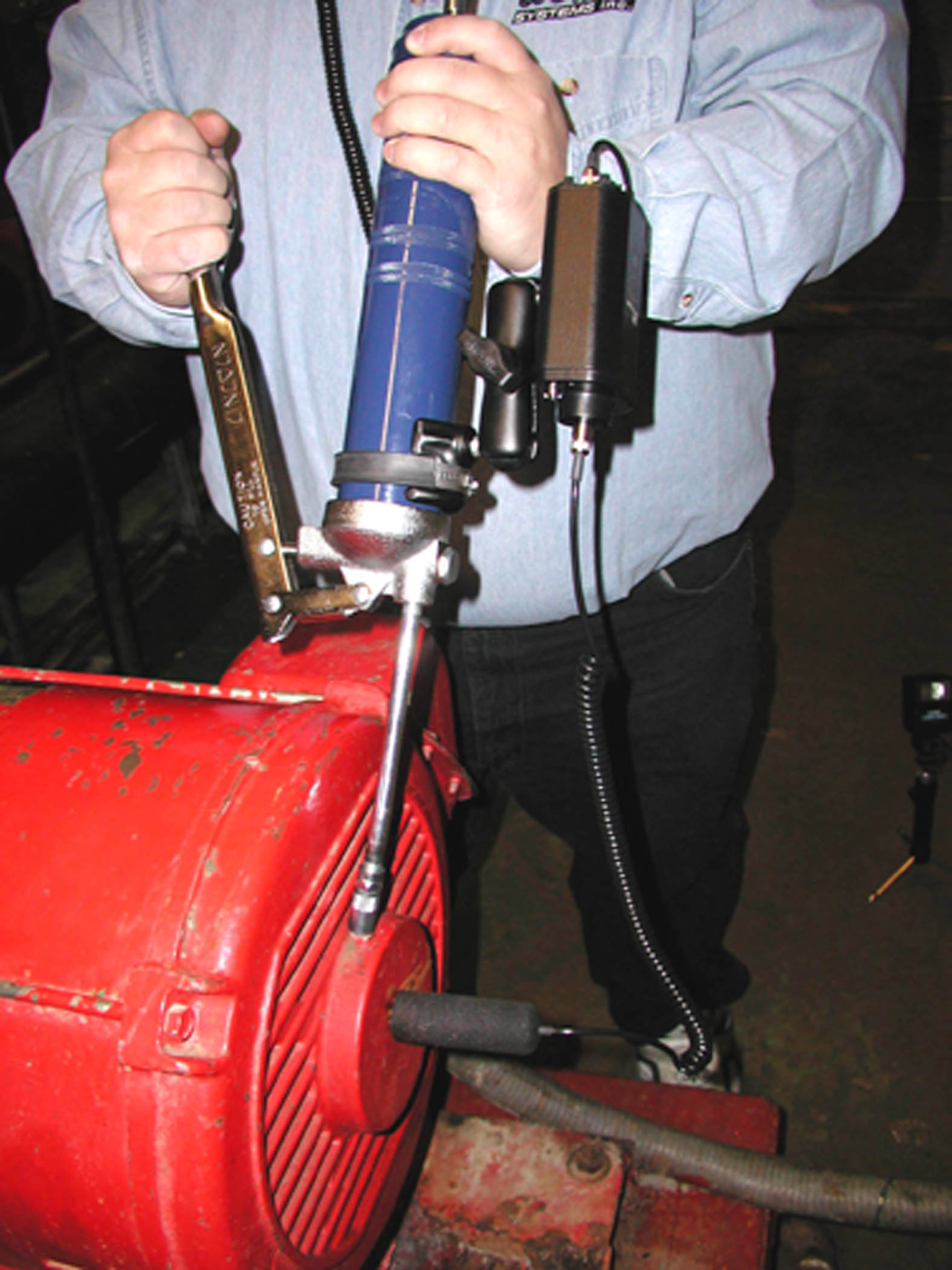

You can have too much of a good thing. When an asset lacks grease, it will quickly make the problem known, usually by failing. At the other end of the spectrum, over greasing can have a similar effect. That’s why it’s important to remember that lubricants have volume of their own. Too much grease could actually cause an asset to jam, necessitating additional maintenance and hours of downtime.
Likewise, over-greasing may lead to seal failure. Grease guns can produce an extraordinary level of pressure, and, in excess, harm bearings. Similarly, when grease dries and cracks, the pressure of additional lubricant can cause it to break apart, further damaging the bearings. An ultrasound reading can help technicians know when enough is enough.
2. Under-lubrication
A lack of lubricant is likely one of the easiest problems to spot. Assets that aren’t properly maintained will make themselves known in short order. Typically, excess heat and sound will radiate from the asset until failure. Alone, these symptoms are easy to detect, but within a noisy facility, they could go unnoticed.
Ultrasound equipment such as the Ultraprobe® 201 Grease Caddy can help facilities save on operating costs by providing a visualization of ultrasonic waves. In doing so, personnel will know exactly when an asset needs lubricating and when it’s in working order. This process saves man-hours so they can be applied to situations of greater need. Plus, the device is easy to use, even in crowded and noisy environments.

A condition monitoring policy that includes housekeeping protocols will ensure that contamination has a minimal impact on asset uptime. However, visual inspection may not be sufficient to determine if contamination has occurred. An ultrasound tool can pinpoint discrepancies in the ultrasonic output of a bearing, notifying maintenance personnel in well in advance of equipment failure.
An improved lubrication program starts with accurate data. Whether your facility utilizes a condition-based lubrication strategy or a preventive method, your technicians need more data if they’re going to make any progress.
The Ultraprobe® 401 Digital Grease Caddy Pro is the perfect blend of data management software and advanced digital technology. With this all-in-one device, your lubrication personnel can create baseline decibel levels, then take readings before and after lubrication to ensure the asset functions properly. In addition to solving these issues at their source, the device allows for quick cost calculations regarding the lubrication program.
