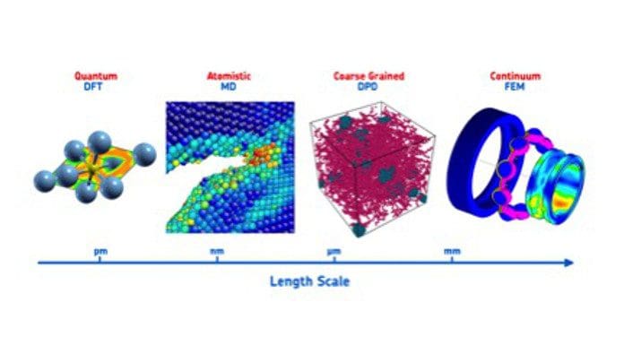

Length scales of the different simulation methods used within SKF, namely density functional theory (DFT), molecular dynamics (MD), dissipative particle dynamics (DPD) and the finite element method (FEM).

When it comes to mechanical parts, e.g., rolling bearings, most design issues can be worked out using “large scale” simulation techniques, such as the widely used finite element method (FEM). However, some special issues go beyond the capabilities of this modelling tool and require being treated with alternative mesoscopic and microscopic simulation methods.
To get a thorough understanding of SKF’s products and be able to tackle the issues that might have an origin at particular time and length scales, scientists at SKF are constantly developing their know-how in the use and advancement of multi-scale simulation methods. This means that there are different tools (imagine magnifying glasses, all with a different magnifying power) that can be used to understand specific phenomena that determine the behaviour of a material in application conditions. This is why the models that are applied at SKF range from quantum mechanical to continuum (fig. 1).
