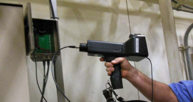

The ultrasound remote access sensors can also be connected to a junction box or switch box. As many as twelve ultrasound RAS’s can be connected to one switch box. Similar to the way vibration analysis switch boxes work, the ultrasound sensors are connected to the switch box, along with the hand-held ultrasound instrument. During analysis, the inspector turns the dial to the next point to collect a reading.
uesystems-02022016-cnt3
The above image shows an ultrasound instrument connected to a four channel switch box.
