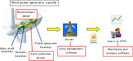

The nacelle*3 of wind power generators generally comprises of main shafts, gearboxes, power generators, and many mechanical components, such as bearings, and gears are built in. If defects in these bearings, gears and other components are discovered too late, problems may spread throughout the entire wind power generator and increase maintenance costs and man-hour, and also result in long periods of time without power being generated. Recently constructed offshore wind power generators in particular are much larger than their onshore counterparts, and access to the generators themselves can be extremely difficult, which means the risk of finding defects too late has increased.
The “CMS” developed by NTN features a data collection device, measurement sensor, and data control, monitoring and analysis software. The world’s smallest class data collection device has been used, which allows installation in nacelles easy, and can be adapted to suit existing wind power generators. With outstanding levels of water and dust-proofing, the device is designed for a variety of different environments, including offshore locations. The device also features automatic diagnosis of highly accurate measurement data, and combined with various different software packages for condition monitoring, the system allows the condition of bearings, gears and other components to be monitored in real-time from remote locations. This system ensures that defects in each component can be identified faster to help prevent spreading damage throughout the nacelle. It also allows preparations to be made for replacement components in advance, and repairs to be conducted systematically, which not only reduces maintenance costs, but also limits reductions in the operating ratio of wind power generators. The “CMS” developed by NTN was the first in Japan to acquire GL*4 certification, a certification system developed for wind power generators.
NTN is already conducting demonstration assessments at multiple locations, and plans to market the monitoring system used in this system globally to help improve the operating ratio of wind power generators. This technology is also planned for a greater number of applications in the new energy fields.

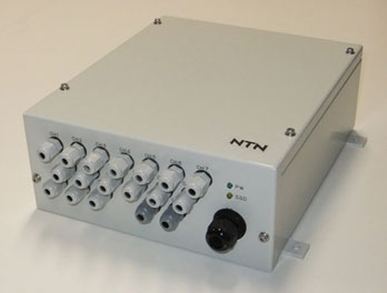

(1) World’s smallest class data collection   device (250×290×108mm)
? Compact and space-efficient, allowing easy   installation in existing nacelles
(2) Suited to offshore installations and a wide   range of other environments (usage temperature conditions: -20 to 60°C)
? Outstanding levels of water and   dust-proofing
(3) Highly reliable diagnosis information
? Automatic diagnosis function using highly   accurate measurements, as well as allowing real-time monitoring and data   analysis
Data collection device
Product dimensions: 250 (W) × 290 (D) × 108 (H) mm
Product weight: 5.0kg
