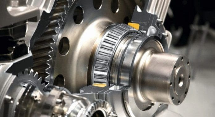

Klübersynth GE 4 80 W 140 offers high resistance to scuffing and micropitting as well as good protection against wear on gear teeth and rolling bearings. The shear stability prevents the lubricant film from collapsing, which is essential to protect both gear teeth and rolling bearings.
The low foaming tendency and anti-corrosion properties of the product enable problem-free gear operation. Klübersynth GE 4 80 W 140 offers a much longer service life than conventional mineral oils, due to the excellent aging and oxidation resistance. As a result, service intervals are extended and maintenance costs are reduced.
