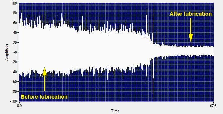

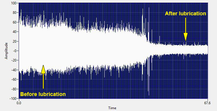

Bearing lube example I:
This is a Time Wave Form of a recorded ultrasound of a bearing in the process of being lubed. The approximately 1 minute sound files shows the bearing before and after lubrication.

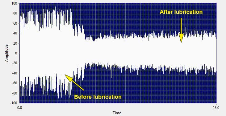

Bearing lube example II:
Another Time Wave Form of a bearing in the process of being lubed over 13 seconds. Again, a distinct before and after lube can be seen.

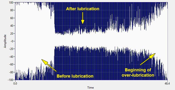

Bearing beginning of over lube:
This recording shows the bearing dB & amplitude increase as more lube is added and has reached the threshold of over lubrication.

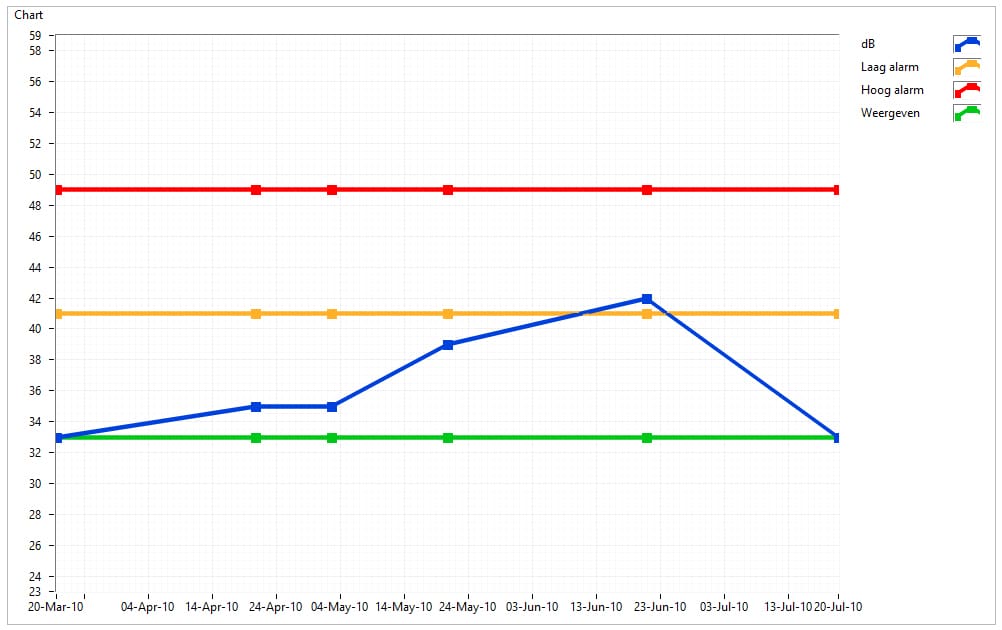

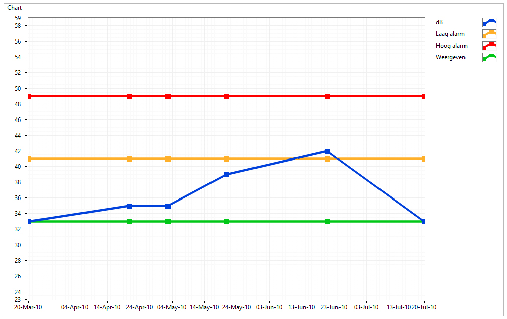

Drive bearing lube history:
This chart shows a trend of decibel readings taken on a drive bearing. The readings are plotted against a baseline dB, a low alarm dB and a more critical high alarm dB.

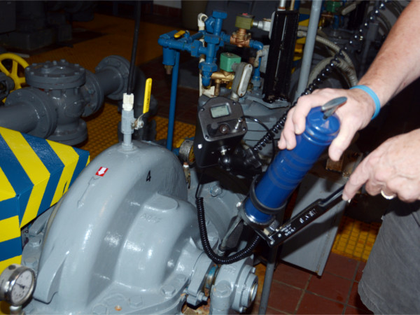

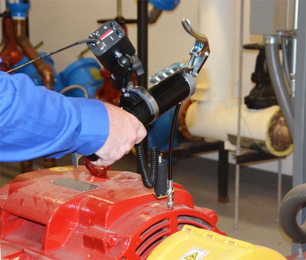

  1. Select your Ultrasound instrument

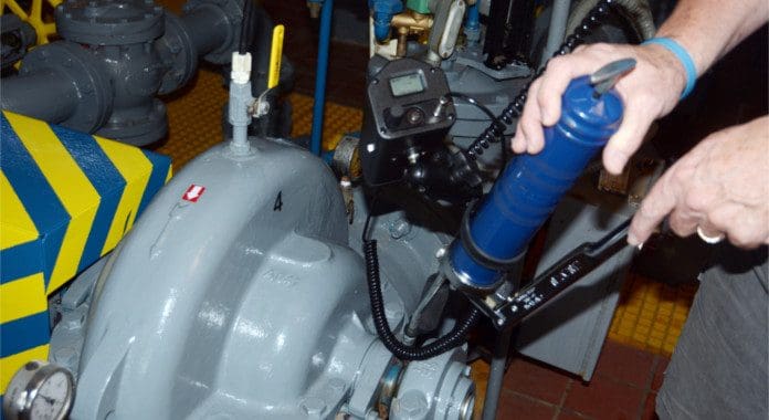

    The first step is to use a proper ultrasound instrument. UE Systems Grease Caddies, for example, are especially designed for bearing lubrication and can even be attached to a grease gun.
  2. Establish baselines
    Then, it is necessary to establish a baseline decibel level and get a sound sample. This is ideally done when moving through a route for the first time by first comparing dB levels and sound qualities of similar bearings. Anomalies will be easily identified.
  3. Trend your bearings
    Once established, each bearing can be trended over time for any changes in either amplitude or sound quality. Generally speaking, when the amplitude of a bearing exceeds 8 dB and there is no difference in the sound quality established at baseline, the bearing needs to be lubricated. To prevent potentially disastrous over-lubrication, the technician will then apply lubrication, a little at a time, until the dB level drops.
