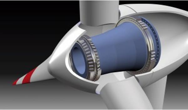

                            NSK bearings shown in position on the main rotor of a wind turbine
Calling upon the company’s extensive experience of the demands that are placed on rolling bearings in wind energy applications, NSK engineers have developed a variety of different designs that are optimally matched to the attributes required of main rotor bearings. For instance, elevated levels of mechanical stress are prevalent as the rotor is exposed to very high wind loads. Although rotational speeds are relatively low at 5 to 20 rpm, the main rotor bearing has to be capable of withstanding both radial and axial loads, including the resulting bending movement of the rotor shaft.
NSKHPS high performance spherical roller bearings featuring a high load factor have been developed specifically for applications of this type, and are manufactured and heat treated in accordance with NSK’s internal Wind Standard U 303.
The breadth of the new range means that a selection of different designs are available. For example, a set of two spherical roller bearings is often used in systems up to 3 MW, while smaller systems frequently deploy a three-point bearing with a single spherical roller bearing (the attached gear is used as the bearing substitute in this configuration).
