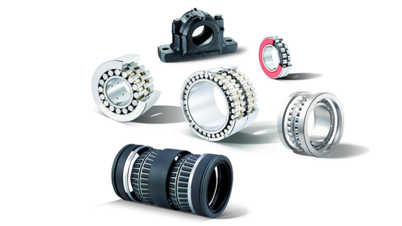

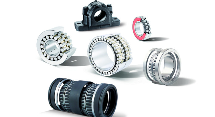

With its rolling bearings, bearing units and transmission seals, NTN-SNR is present across the entire steel-making process, from raw material conveyors, blast furnaces and converters to rolling mills and finishers. A significant proportion of the proposed bearings bear the ULTAGE® label, a guarantee of high performance and increased service life. Furthermore, NTN-SNR has developed special seals for working in this very harsh environment combining heat, moisture and carbon deposits.
  • Bearings for converters
    NTN-SNR has developed double row spherical roller bearings of very large dimensions to be fitted in converters and trunnions. The principle implemented by NTN-SNR consists of fitting one side of the converter with a split bearing with an inner diameter of 1,120 mm, an outer diameter of 1,540 mm and a width of 525 mm. This split design, achieved through a process of breaking without removing material, saves 90% of dismounting time compared with a conventional one-piece bearing, thereby facilitating maintenance and cutting costs.
  • Bearings for continuous casting
    The NTN-SNR rolling bearings for fixed-type, floating-type and intermediate bearings of continuous casting cylinders can cope with the very high load stresses and temperatures of this equipment. Among others, NTN-SNR offers cylindrical roller bearings with a self-aligning feature, split cylindrical roller bearings and SRB ULTAGE® bearings (spherical roller bearings), including a sealed version, SRB ULTAGE® EE, especially suited for high temperature, load and pollution constraints.
  • Bearings for rolling
    To address rolling safety and reliability constraints, NTN-SNR has developed 4-row cylindrical roller bearings for working rolls and backup rolls, and ULTAGE® 4-row tapered bearings. The latter, available in a sealed version, can be used in highly polluted environments without increasing the space requirement, with a service life multiplied by 3. They can also benefit from the Rust GuardTM treatment, a special corrosion-resistant coating that prevents premature failures and extends the bearings replacement cycle by 50%.
NTN-SNR also offers specific support bearings suitable for Sendzimir-type cold rolling mills with thicker outer rings for very high load capacity and high precision. A version with seals optimises the life of cylinders offering the option of using special low viscosity lubricants.
