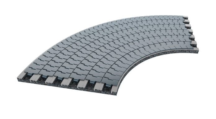

The new TopTrac™ curve design provides high speed and load performance in dry applications. This innovative design allows the user to replace only the high-performance Nolu®-SR wear strips so the entire curve assembly can remain intact. Replacement can be accomplished with the curve in position on the conveyor, which drastically reduces downtime and maintenance. The more homogeneous magnetic field results in a quieter chain operation and less energy consumption.
