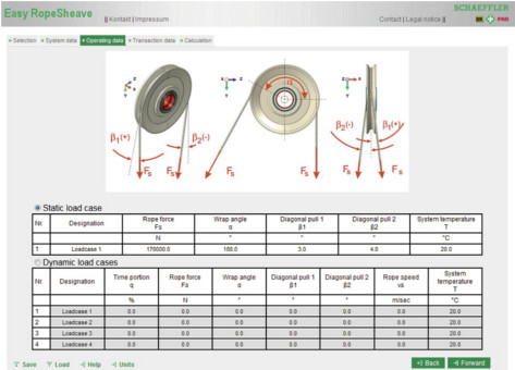

With “Bearinx®-online Easy RopeSheave”, Schaeffler customers can now calculate the static load safety factor and rating life of both single and multiple rope sheave bearings
With “Bearinx®-online Easy RopeSheave”, every Schaeffler customer can now calculate the static load safety factor and rating life of both single and multiple rope sheave bearings. It is available exclusively online and can be used free of charge. Initial registration takes very little time and the customer can begin calculation work immediately.
New: The “Easy series” for online customers
Customers can quickly and safely browse through and compare a range of bearing support variants at http:\\bearinx-online-easy-ropesheave.schaeffler.com. The self-explanatory menu navigation enables users to enter data quickly and easily for modeling, bearing selection, and operating data.

The calculation program is available exclusively online and can be used free of charge. Initial registration takes very little time and the customer can begin calculation work immediately.
The data for radial roller bearings, radial deep groove ball bearings, and radial tapered roller bearings from the INA and FAG brands are stored in the database and can be accessed and integrated into the calculation process at any time. Influencing factors that are typical for the application, such as consideration of the rope sheave material, the integration of a bush between the bearing and plastic rope sheave, precise data on the bearing’s internal geometry, and the influence of the system temperature on the bearing clearance are also relevant for the calculation.
