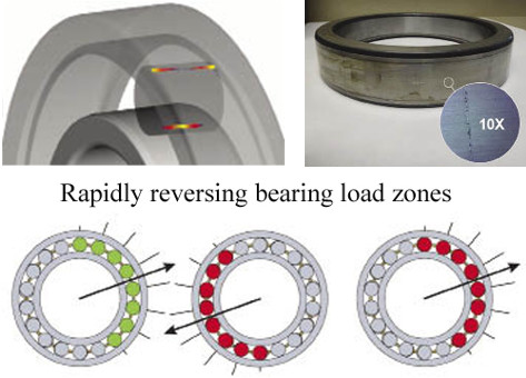

Fig-7_optAligned (green) rollers are in a load zone. Misaligned rollers (red) are 180° to the loaded ones. In a transient torque reversal, unaligned rollers are suddenly loaded, then unloaded, and repeatedly in a short period.

Rapid torque reversals
What is it about a turbine drivetrain that causes it to be so susceptible to the rapid and severe torque reversals? This has to do with the relative rotating masses (inertias) of the blades and the generator rotor, and how they can react against each other within the torsional natural frequency of the drive system. A typical turbine has 80 to 90% of its relative inertia in the blades, with most of the rest of the inertia in the generator rotor. In normal operation, the blades are driving the generator in the positive direction. A grid disconnect, emergency stop, or high-wind shutdown triggers rapid aero braking of the blades that attempts to decelerate the drive system. Most of the aero braking effort goes into decelerating the massive blade inertia, but some of it goes through the drive system to decelerate the generator. This typically causes a torque reversal in the drive system that can result in the inertias of the system winding up and unwinding against each other several times at the torsional natural frequency of the system as it decelerates. Note: The 1 and 2 MW turbines have similar natural frequencies despite the significant size difference in the turbines. How do these reversals cause impact loading in the bearings?
Rapidly reversing bearing load zones and impact loads on misaligned rollers, damaging to bearings in other types of equipment, can cause WEA damage. Rapidly reversing bearing load zones are also known to decrease bearing life. During TTRs, every bearing in the gearbox sees a rapid load zone reversal of almost 180° that can cause severe impact loads between rollers and raceways. All the cited research recognizes that impact loading could be the source of the stress-induced subsurface WEA damage, and most of the findings name it as a suggested leading candidate.

During normal operation, rollers in the bearings are aligned and rolling at the expected or design speed while they are in the load zone. As they leave the load zone, the rollers slow down and can misalign within the tolerance of the cages. As they approach the load zone again, they are gradually brought back into alignment and smoothly accelerate to support the load. In a rapid load zone reversal, the unloaded rollers opposite the normal load zone are suddenly loaded while in this misaligned state. This rapid loading increases the load concentration of the rollers in the middle of the inner race.
Although load reversals are common to many types of equipment, torque reversals of the magnitude and rapidity common in wind turbines is rare in other equipment. And helical gearing commonly used in wind-turbine gearboxes adds additional subsurface stress and strain. With helical gearing, every cylindrical bearing will see high axial loads simultaneous with the radial loads impacting misaligned rollers. Cylindrical rollers may slip axially and damage the raceway surface, further decreasing bearing life through pitting and spalling. Sliding can also result in scuffing the raceway, causing microscopic cracks that let subsurface entry of water or aggressive oil additives to initiate hydrogen induced WEA.
If the radial impact load is so high that the roller breaks through the oil film, it can create mixed friction sufficient to prevent slipping axially. Axial subsurface stresses will be added to the Hertzian stresses from the radial impact, magnifying the peak stresses. The strain rate would be magnified as well. The potential to exceed a threshold where WEA microstructural alterations could form, explains why WEA damage is common in wind-turbine gearboxes and rare in most other bearing applications. Tapered-roller bearings can also be damaged by the affects of load reversals. Those used on high and intermediate-speed shafts typically are not preloaded due to thermal constraints, and can see damaging axial movement and impact loads.
