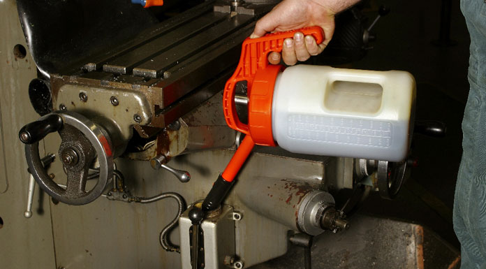

5. Oil dispensing is an art
No, it is a question of using the right tools for the job. Oil cans need to have these basic requirements: fully sealed, translucent for inspection, color coded and identified and adapted to the application and fluids, preferably made from plastic to avoid rusting.
Forbidden are open steel cans or bottles, funnels or similar that attract contamination instead of keeping dirt and moisture out! Unfortunately we see these bad practices and dirt collectors every day in use.
