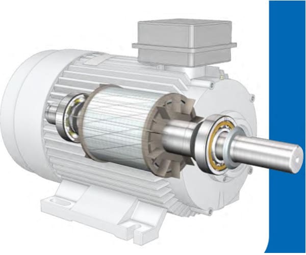

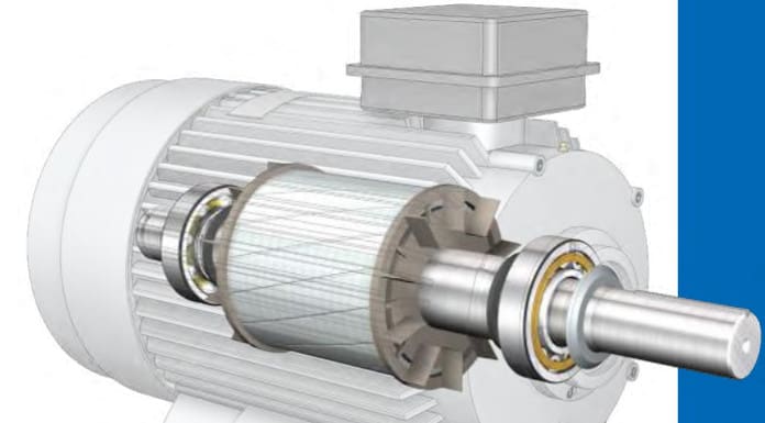

5 most common causes of bearing failures in electric motors and what to do about them
The following five factors can produce its own particular type of damage and leave its own special imprint on the bearing. Consequently, by examining a damaged bearing it is possible to determine the root cause of the damage so that the requisite actions can be taken to prevent a recurrence.
