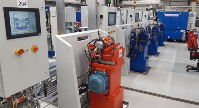

                                                                                BRAVE test rig

SKF is looking to solve this problem at its Research and Technology Development (RTD) centre in Houten, The Netherlands. The company has started work on the construction of an experimental verification facility there that it will use to increase its knowledge of the mechanisms that cause bearings to fail. It will also use the facility, which will be called Bearing Rigs for Accelerated Verification Experiments (BRAVE), to develop ways to predict the remaining useful life of these critical components rapidly, accurately and repeatably.
                                                      Edwin Tummers
Team Leader for Bearing Steels, Urszula Sachadel, and Edwin Tummers, Team Leader for Experimental Verification at SKF have been running this project. “We needed a flexible testing facility where we could simulate different application conditions and see how a bearing system, including the materials from which it is made, and the lubrication employed, performs when operating under different loads and at different speeds. We also needed to be able to do that in a way that allows us to perform investigations on that system, so we can determine how defects are generated, how they progress and how long the bearing will last until maintenance is required,” says Tummers.
When completed, BRAVE will feature a number of rigs specifically designed and tailored to meet SKF specifications will be used by researchers to develop and experimentally verify bearing failure models. The functions of these rigs will be categorised as ‘contaminate’, ‘initiate’ and ‘propagate’, and they will be often used in sequence. Sachadel explains: “With the contaminate set-up, for example, we can generate defects, such as dents, abrasion, electrical damage and corrosive damage in the bearings in different ways. We can also apply different lubricants. In the initiate set-up, we can then run the bearings under certain conditions to create some initial damage to them. Finally, in propagate, we can determine how different load and speed conditions influence the rate at which this damage spreads”. Each set-up type can also be used in isolation, or in a ‘mix-and-match’ approach, enabling a wide range of tests to be performed.
In this way, Sachadel says, SKF researchers can screen many different variants of bearings very quickly to determine the best solution for a given application. Test procedures will be developed, controlled and monitored closely, and all of the data, regarding things such as vibration, temperature and load history will be recorded. This data can then be analysed in detail during or after the experiments.
Sachadel continues: “Using BRAVE, we will be able to quickly evaluate potential bearing solutions, screen them, and understand the impact of different manufacturing processes on their performance. Further, in the future, we can use the data we gather to support our development of artificial intelligence and machine learning techniques to predict or improve the performance of our bearings.”
