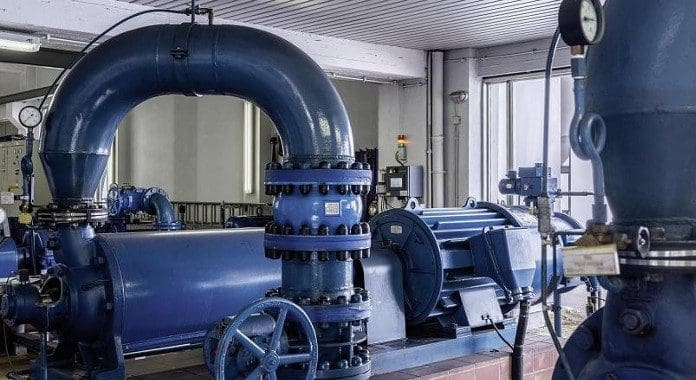

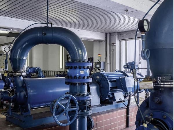

The Perlenbach water supply association in Germany’s Eifel region relies on solutions from Schaeffler when it comes to preventive maintenance.
SCHWEINFURT/HANOVER, April 3, 2018. At the Hannover Messe 2018, Schaeffler will present intelligent solution packages for machine monitoring and lubrication, illustrated using reference projects. One such customer is the Perlenbach water supply association, which supplies fresh drinking water to around 50,000 residents in seven municipalities of Germany’s Eifel region every day. Ensuring fault-free, reliable operation would mean manning and monitoring the association’s facilities 24 hours a day, as bearing defects in the centrifugal pumps could cause them to fail and compromise the security of the water supply. Perlenbach therefore decided to utilise a system that would continuously monitor and lubricate the machinery. In Schaeffler, the water supply association found an expert partner to help implement a Predictive Maintenance system.

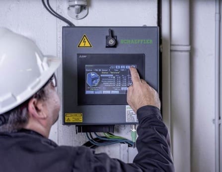

Together with the Concept8 lubricator, the preconfigured SmartQB condition monitoring system from Schaeffler ensures fault-free operation. This standalone complete solution detects irregularities in electric motors, pumps, fans and the rolling bearings that all of these rely on. The SmartQB identifies the potential cause of failure – whether it’s bearing damage, imbalance, friction, temperature increase, or changes to the vibration pattern – and gives a clear text notification of the findings. The integration of the system, which was developed in partnership with Mitsubishi Electric, into the control room visualisation means that maintenance staff are informed of incipient damage at an early stage and can immediately initiate maintenance measures and procure any replacement parts that might be needed. As Joachim Dankwardt, deputy manager of the water procurement/treatment department at the Perlenbach water supply association, is well aware: “For us, condition monitoring means a secure supply.”
As a preconfigured plug-and-play system, the SmartQB requires no previous knowledge of condition monitoring.
No previous knowledge required
A major advantage of the solution is that the SmartQB is a preconfigured plug-and-play system, which makes it very easy to put into operation. “Conventional systems for machine monitoring are costly and complicated. In contrast, the SmartQB is so easy to use that our employees did not require any specific knowledge of vibration diagnosis. We were able to start right away,” reports Mr. Dankwardt. The electrical specialists on site were able to connect the SmartQB directly to the control system and the emergency telephone equipment.
