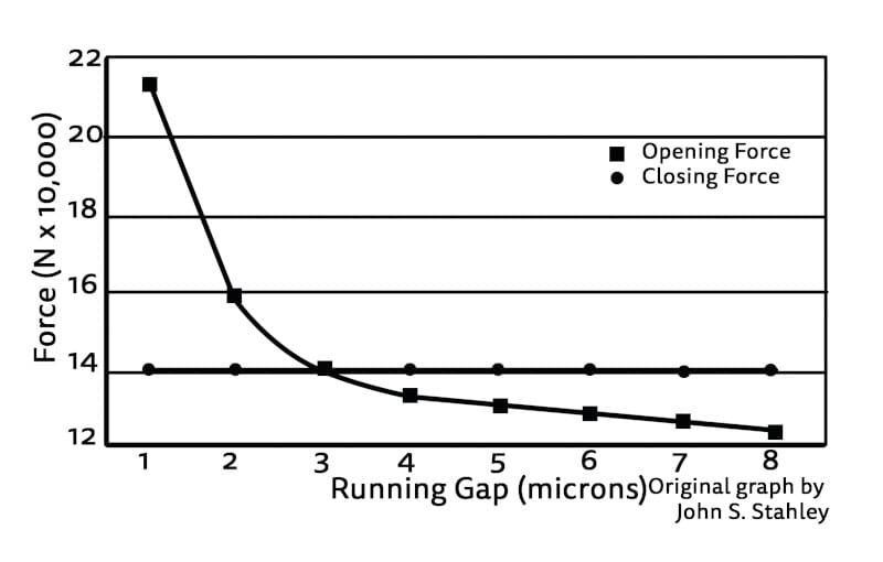

Dry Gas Seals (DGS), often used in compressors, provide an opening force at the seal
faces. This force is created by an aerodynamic bearing principle, where fine pumping grooves help encourage gas from the high-pressure process side of the seal, into the gap and across the face of the seal as a non-contact fluid film bearing. As the closing force on the faces goes up, this aerodynamic bearing layer will get thinner but stiffer, as shown by Stahley (Image 1).
Image 1 – The aerodynamic bearing opening force of a dry gas seal face. The slope of the line is representative of the stiffness at a gap. Note that the gap is in microns.

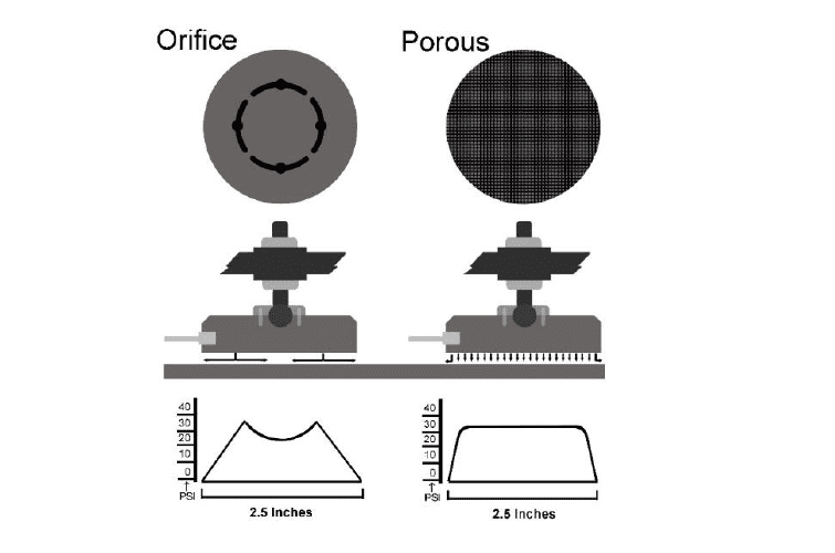

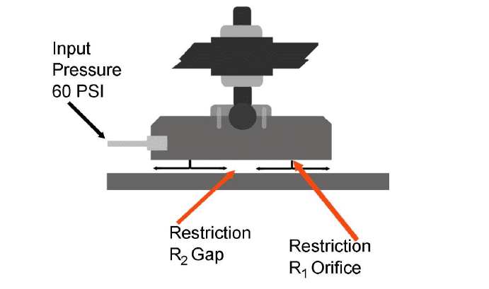

As an example, under a flat orifice compensated gas bearing (Image 3), the average
pressure in the gap will equal the total load on the bearing divided by the face area, this is unit loading. If this source gas pressure is 60 pounds per square inch (psi) and the face has 10 square inch of area and there is 300 pounds of load, there will be an average of 30 psi in the bearing gap. Typically, the gap would be about 0.0003 inches, and because the gap is so small, the flow would only be about 0.2 standard cubic feet per minute (scfm). Because there is an orifice restrictor just before the gap holding pressure back in reserve, if the load increases to 400 pounds the bearing gap is reduced to about 0.0002 inches, restricting flow through the gap down 0.1 scfm. This increase in the second restriction gives the orifice restrictor enough flow to allow the average pressure in the gap to increase to 40 psi and support the increased load.
Image 3 – This is a cutaway side view of a typical orifice air bearing found in a coordinate measuring machine (CMM). If a pneumatic system is to be considered a “compensated bearing” it needs to have a restriction upstream of the bearing gap restriction.
Orifice vs. Porous Compensation

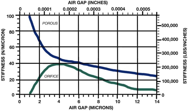

Orifice compensation is the most widely used form of compensation (Image 4). A typical
orifice may have a hole diameter of .010 inches, but as it is feeding a few square inches of area, it is feeding several orders of magnitude more area than itself, so the velocity of the gas can be high. Often, orifices are precisely cut from rubies or sapphires to avoid erosion of the orifice size and so changes in the performance of the bearing. Another issue is that at gaps below 0.0002 inches, the area around the orifice starts to choke the flow to the rest of the face, at which point collapse of the gas film occurs (Image 5). The same occurs at lift off, as only the area of the orifice and any grooves are available to initiate lift. This is one of the main reasons externally pressurized bearings are not seen in seal plans.
Image 4 – The even pressure profile of porous gas bearings makes them more suited for application to sealing technology.
Image 5 – Lift vs. load chart comparing orifice and porous externally pressurized gas bearings. At small gaps orifice bearings collapse but porous bearings behave as dry gas seals and oil bearings.
This is not the case for the porous compensated bearing, instead the stiffness continues to
increase as load increases and the gap is reduced, just as the case with DGS (Image 1) and
hydrodynamic oil bearings. In the case of externally pressurized porous bearings, the bearing will be in a balanced force mode when input pressure times the area equals the total load on the bearing. This is an interesting tribological case as there is zero lift or air gap. There will be zero flow, but the hydrostatic force of the air pressure against the counter surface under the face of the bearing still unweights the total load and results in a near zero coefficient of friction—even though the faces are still in contact.
For example, if a graphite seal face has an area of 10 square inches and 1,000 pounds of
closing force and the graphite has a coefficient of friction of 0.1, it would require 100 pounds of force to initiate motion. But with an external pressure source of 100 psi ported through the porous graphite to its face, there would be essentially zero force required to initiate motion. This is despite the fact that there is still 1,000 pounds of closing force squeezing the two faces together and that the faces are in physical contact.
A class of plain bearing materials such as: graphite, carbons and ceramics such as
alumina and silicon-carbides that are known to the turbo industries and are naturally porous so they can be used as externally pressurized bearings that are non-contacting fluid film bearings. There is a hybrid function where external pressure is used to unweight the contact pressure or the closing force of the seal from the tribology that is going on in the contacting seal faces. This allows the pump operator something to adjust outside of the pump to deal with problem applications and higher speed operations while using mechanical seals.

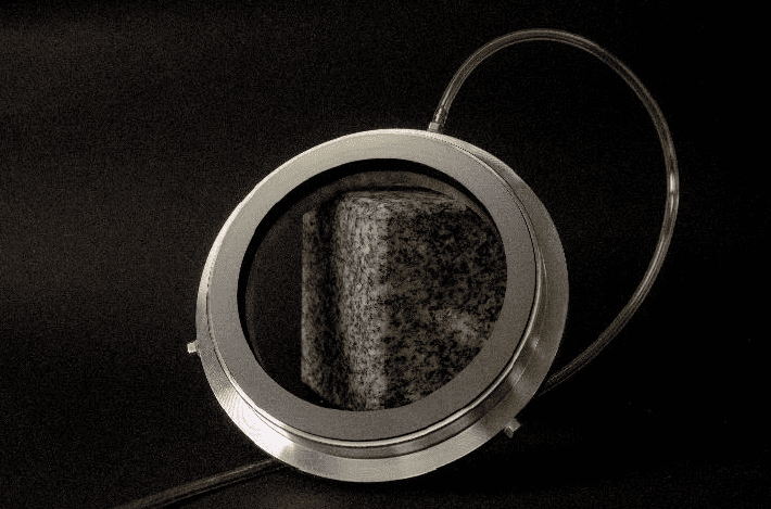

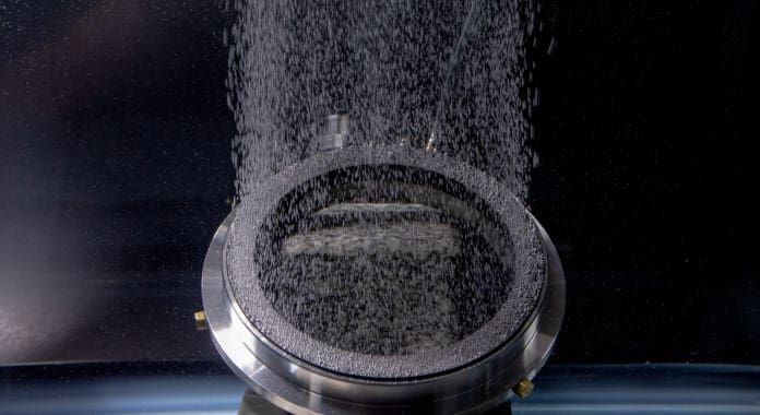

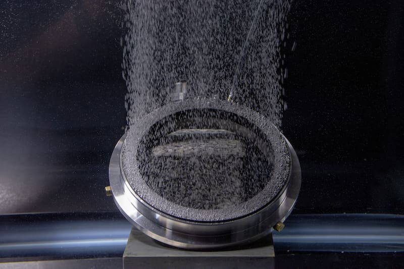

                       Image 6 – A mechanical seal face of porous graphite that has been lapped flat.
Image 7 – A mechanical seal face of porous graphite showing air bleeding out of the flat lapped face. The input pressure may be adjusted to create a hydrostatic force reducing contact pressure.
