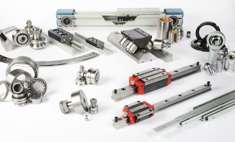

Nadella linear products are primarily based around rollers, rather than recirculating ball bearings. Recirculating bearing systems are very common in profile rail guide systems. Profile rail guide systems are now very common components in many machines and automation in general. However, they are not always the optimum solution for linear guidance.
In applications where there is a high degree of contamination, or other similar harsh environments, profile rail guide systems can be problematic. Contamination enters the recirculation system and commonly causes poor performance and even premature product failure. It is almost impossible to clean out this contamination once in the recirculation system. Whilst there are various seal options to help in mitigation, none of these are 100% effective in many applications. Nadella uses sealed rollers running primarily in ‘open’ rail guides. In this manner contamination cannot enter the rollers and can easily be cleaned from the rail guides. Stainless steel products and special surface treatments are also available, if demanded by the application.
Profile rail guide systems are also very demanding with regards to a suitable mounting surface and rail alignment. These requirements can be costly to implement, as a result of increased machining and installation time & difficulty. Nadella uses fixed rollers combined with floating rollers; in this way alignment tolerances are far greater than profile rail guide systems (e.g. typically 0.5-1.0mm, rather than 50 microns [50/1000th of a mm]). This can result in a considerable cost saving, as installation is quicker & much more straightforward.
