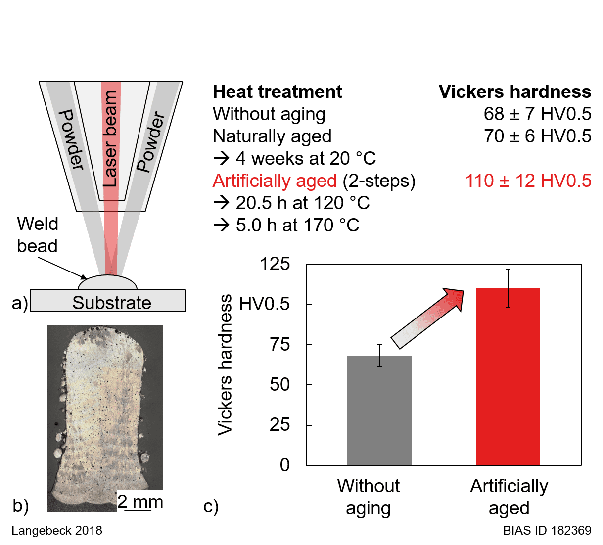

The principle of the used LMD-technique is shown in figure 1 a). Compared to powder bed based additive manufacturing techniques, the LMD process convinces through a nearly limitless assembly space and high build-up rates. These advantages of the laser metal deposition are mandatory for an economic additive manufacturing of large-scaled rolling bearings with diameters up to 3 m. In first tests with the high-strength aluminium powder EN AW-7075 (50 μm to 125 μm) low-defect specimens could be manufactured (see figure 1 b)). The following hardness measurements according to Vickers on a transverse section showed a low hardness value of 68 ± 7 HV0.5. After artificially aging at elevated temperatures a higher Vickers hardness of 110 ± 12 HV0.5 was measured (see figure 1 c)). This shows that already artificial aging, without a previous solution treatment after the LMD process, leads to a significant increase in hardness.
Figure 1 a) Schematic sketch of the LMD-process; b) Etched transverse section of an additively manufactured specimen out of EN AW-7075; c) Averaged hardness values of EN AW-7075.
