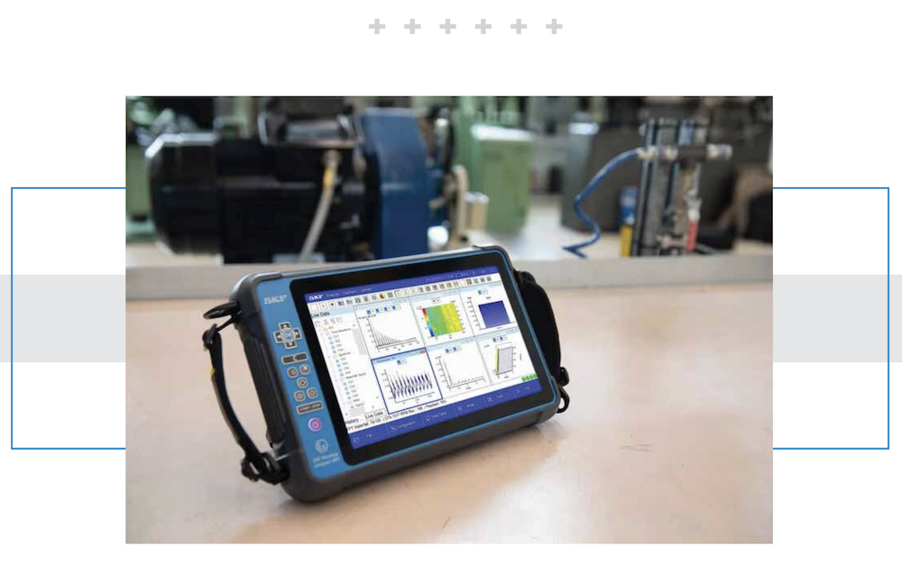

Some of the biggest users of handheld data collectors require hazardous area certification to prevent fires, explosions, and catastrophic accidents. These users operate in sectors including Oil & Gas, Petrochemical, Biofuel, Wastewater treatment, and some mining applications. Without hazardous area certification, it’s not possible to safely operate in these environments. SKF is continuously striving to expand its condition monitoring offering and bring new value to customers and industries. This led to the development of a hazardous area-approved Microlog Analyzer dBX model CMVA 90-EX that is approved for use in ATEX, IECEx, Class I Division 2 and Class I Zone 2 rated areas.
How does this new version of the Microlog Analyzer dBX differ technically from the standard version?
The Microlog Analyzer dBX is SKF’s most advanced portable vibration monitoring device. The hazardous area-approved version is almost identical from a technical features and capabilities perspective to the standard version. However, it has been designed to enable safe operation of electrical equipment in hazardous areas by limiting the amount of stored and transmitted electrical energy to prevent sparks or high temperatures that could ignite gases. In addition, the SKF Microlog dBX CMVA 90-EX kit includes hand and neck straps that are specifically designed for hazardous environments as well as a hazardous environment rated general purpose accelerometer, cable and magnet mount. With any hazardous area device, there are important considerations for use.

MPA stands for Multiple Point Automation. This is one of the key improvements with the Microlog dBX platform as compared to legacy CMXA series Micrologs. The Microlog dBX platform offers more advanced computing capabilities, enabling the user to configure up to 12 measurements for automatic data collection at one measurement point. Using the same sensor, the user needs to press only one button to collect all pre-configured MPA measurements. As a result, field experience has shown up to three times faster data collection. For SKF customers, this means less time collecting data and more time troubleshooting and resolving issues.

The built-in camera enables quick, visual confirmation of equipment condition and sensor placement without the need for a separate hazardous approved camera. It allows the operator to capture images of machinery and environmental factors during data collection, providing valuable context to vibration readings. This visual documentation improves diagnostic accuracy, supports remote analysis, and streamlines reporting while reducing time spent in potentially dangerous locations, thereby increasing both safety and efficiency in field operations.
