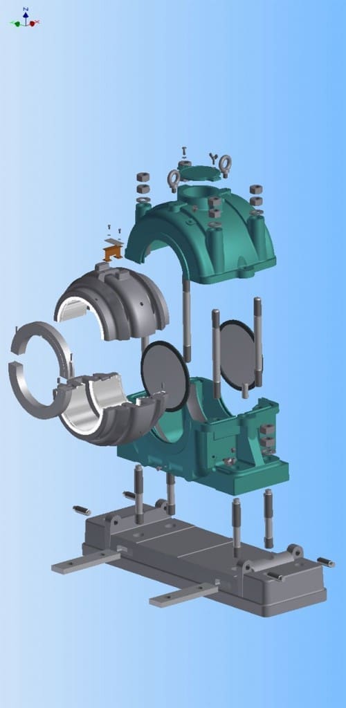

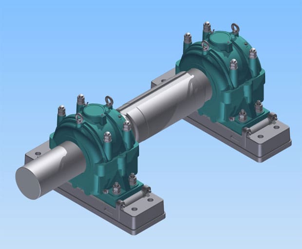

ALC bearings have diameters ranging from 200 to 400 mm, and thus respond to the specific requirements of most of the transmission shafts of rotating machines.
ALC white metal bearings’ main benefits are:
  • An easy and fast assembly
  • An excellent tolerance to shaft behaviors: ALC ball bearings can adjust to the different shaft movements to reach optimum stress distribution in the bearing. The bearings are wear- and vibration-resistant. If the lubrication is correctly carried out, wear is close to zero, reaching a very long service life.
  • Minimal space requirements
  • Unrivaled service life
  • Low maintenance
  • Product manufactured with independent spare parts. The benefit is to have the possibility to replace one piece with another without replacing the whole product. Disassembly can be effected as quickly as assembly.

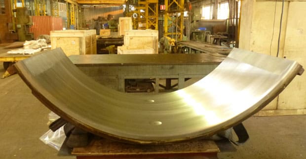

Taking advantage of its mastery of the cast Babbitt know-how, ALC Tournai proposes to assist its clients in the repair of any type of pieces –medium-sized to very large pieces– with an antifriction metal lining.
alc-tournai-cnt6
alc-tournai-cnt7
With the mastery of rod and static casting techniques, ALC Tournai offers the most economical repair or replacement solution.
