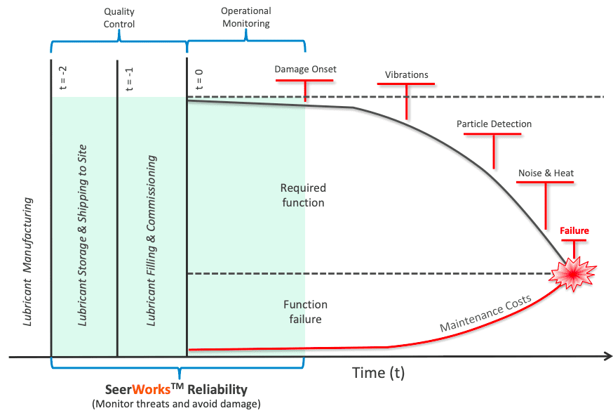

For wind turbines, about 80 percent of gearbox rolling bearing failures are caused by white-etching cracking (WEC), resulting in expensive maintenance and lost revenue. At very irregular stages of operation, WEC leads to sudden failure of the bearing after as little as 5 to 20 percent of the estimated service life as defined in DIN 281 for classic rolling contact fatigue. Although gearboxes are designed to last for more than 20 years, they are known to fail after as little as 6 to 24 months in service due to WEC. If the WEC damage is ignored, further damage can cascade and wear down other crucial machine elements.
Reliability-as-a-Service

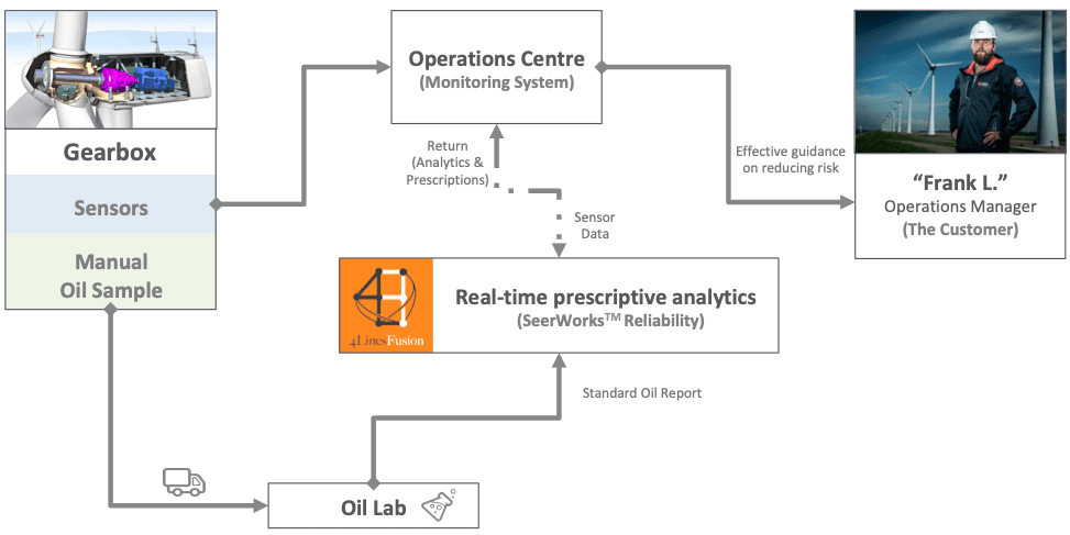

A major goal of SeerWorksTM Reliability is to promote proactive, evidenced-based maintenance rather than schedule- based maintenance as a strategy for optimizing maintenance intervals, oil consumption, and facilitate cost savings. Applied to identify hidden inefficiencies in lubricated rotating equipment, the technology provides prescriptive online asset monitoring not only for classifying WEC but also assessing the threat of stress-corrosion cracking, lubricant filterability, advanced oil analysis reporting, and delivering recommendations for reducing risk.
As the primary product, SeerWorksTM Reliability can easily be incorporated in existing digital platforms and integrated into users’ current workflows. The services can be provided by securely interfacing SeerWorksTM Reliability directly with a third-party service provider, and/or through installed sensor concepts and other concepts that implement reactive measures. In addition to the SaaS solution SeerWorksTM Reliability, 4LinesFusion also offers its clients consulting services and other custom work relating to lubricated contacts, referred to as SeerWorksTM Digital Labs. Custom solutions are currently provided in the fields of lubricant development (oils and greases), false brinelling, root-cause analysis, and claims management.
