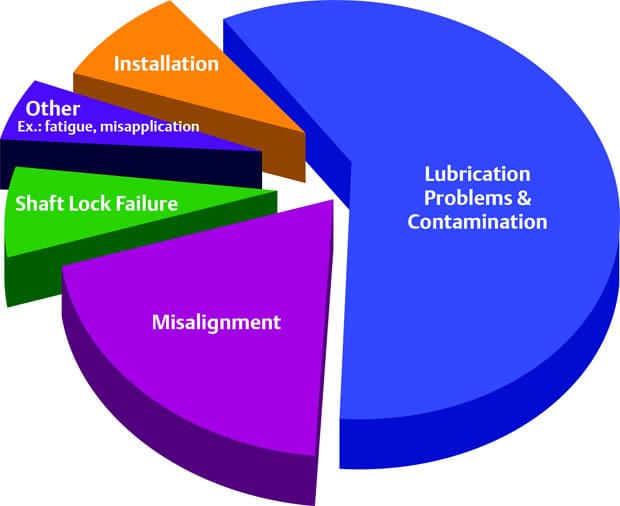

The industry of wheels turn on bearings, so why do the wheels often vibrate, clatter, squeak, drag and overheat? Bearings can fail for lots of reasons. Most failures (as shown in Figure 1) are related to lubrication and contamination, but myths and misconceptions handed fromwheel bearings, one generation of maintenance engineers to the next help perpetuate many easily avoidable problems. These myths fall into three general areas of bearing use: installation, misapplication and lubrication.
regal-cnt1
Figure 1 – Sources of bearing wear or failures

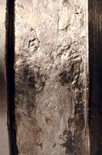

Scratching, gouging and general wear in the bore of an inner ring and on the OD of a shaft are indications of loss of lock. Sometimes, the setscrew tips will also be worn. Fretting wear can be present on the surfaces and is sometimes a precursor form of wear prior to loss of lock.
This can be caused by improper tightening of the locking mechanism, undersized/worn/damaged shafting, frequent start/stop operation, or hardened or stainless steel shafting that prevents set screw penetration or holding.

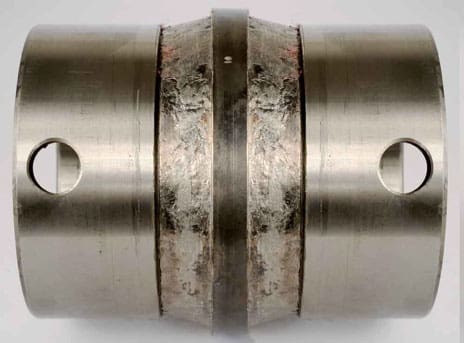

Surface smearing, peeling and skidding are forms of adhesive wear that occur when operating with insufficient oil film thickness. Under these conditions, sliding occurs between the rolling elements and raceways causing surface deformation, cold welding and/or material transfer.
Causes include:
• Inadequate lubricant properties
• Lubrication breakdown
• Ineffective relubrication
• Mixing of incompatible lubricants
• Insufficient load at high speeds
• Sudden acceleration/deceleration

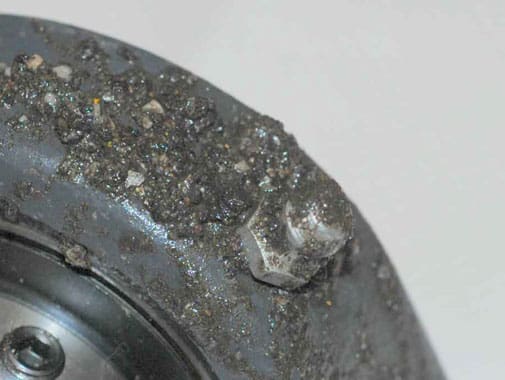

Request image filename: Grease.jpg – Before lubricating a bearing make sure the grease fitting is clean so contamination is not introduced into the bearing during relubrication.

Lubrication myth #5: Just shoot grease through the fitting – FALSE.
Always clean grease fittings and the grease gun tip. It’s good practice to put the grease gun tip in an oil bath or wrap it with a plastic cover to protect it.
