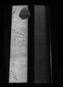

Defects occur naturally on the surface of bearing rollers when in the production pipeline. The common defect categories include damage caused by mechanical collisions, corrosion due to ageing, and material lacking, and grind lacking. These defects are mainly observed on the chamfers, cylindrical surface, and end surfaces.

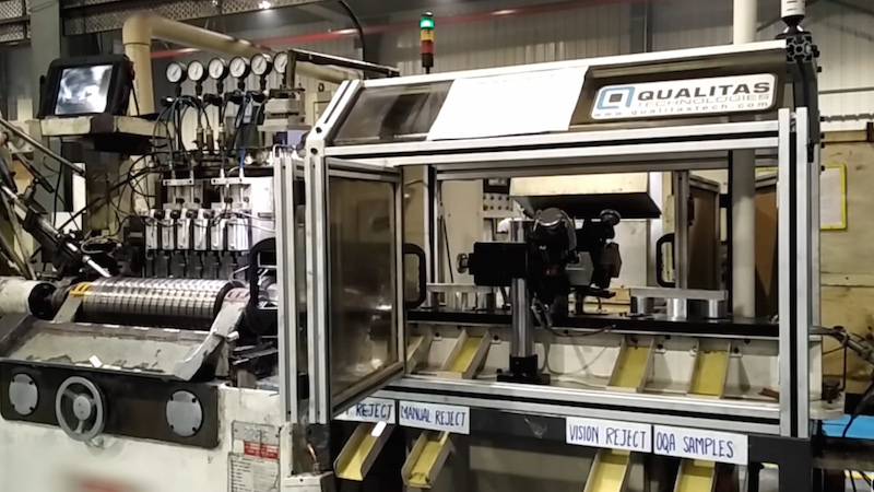

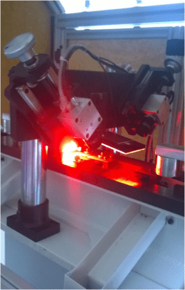

- Install
Primarily, we installed a set of three cameras at some specific angles and a red panel lighting system to best capture the defects on the rollers. We focused on the use of red lights instead of white lights to minimize the reflection on the bearing surface, which could have resulted in undetected surface defects.

- Inspect
The AI-based Anomaly Detection Technique was used to accurately identify the defects on the roller’s body and face.

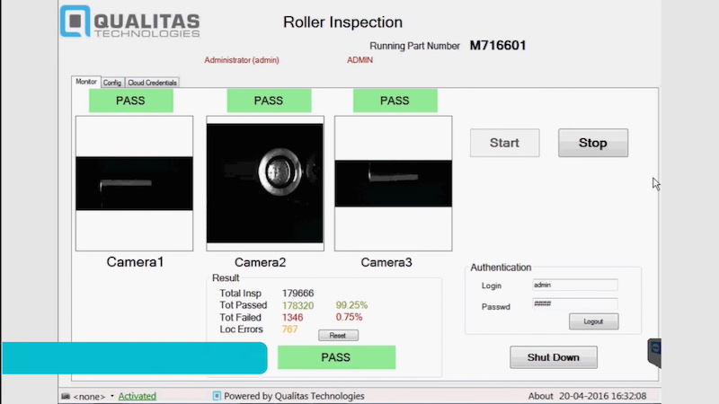

- Improve
Deep Learning (DL) programs were built to train the machine vision system to better understand the different types of surface anomalies on the bearing rollers. Also, the results can be displayed on the user interface in real-time.
Coming up with a system that was fast enough to fit in properly with fast production speeds as well as to train that model to inspect a massive variety of defects while maintaining an accuracy of over 85% was a two-fold challenge. However, using our state-of-the-art technologies and extensive expertise, we succeeded in creating an accurate and fast bearing inspection that was at par with the client’s expectations.
Our machine vision solution was capable of performing accurate defect detection and rejection of defective products. Some prominent features of the inspection procedure are following:
- Capable of identifying NCU, shallow recess, grinding damage, and spiral defects with an accuracy of over 98%.
- Eliminated the need for staffing out of the inspection loop.
- Would enable considerable operational cost savings in the long run.
- Enabled quicker turnaround with an inspection cycle time of 150-200 milliseconds.
