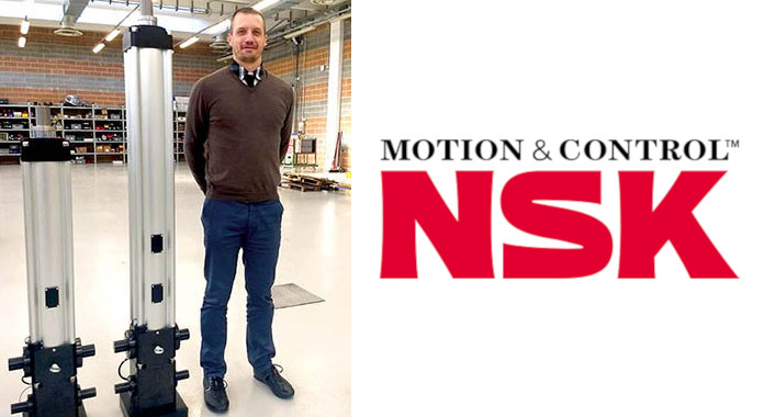

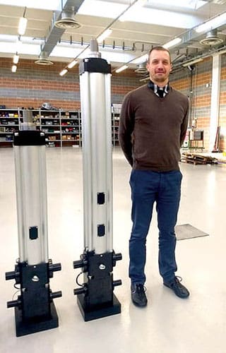

Gianpaolo Baracco, NSK Sales Engineer PSL, European Industrial Business Unit, with the two electro-cylinders featuring HTF ball screws

Automationware was in the process of developing large electric actuators (cylinders) for the
translation of heavy moulds used in injection moulding presses. Destined for machines that
stand at over 6m in height, the cylinders produce up to 80kN of force and travel at a velocity of up to 1m/s.
