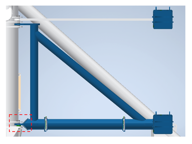

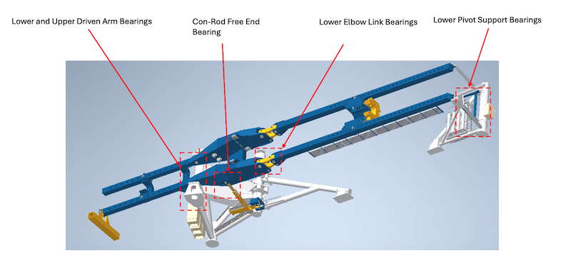

Acorn was called in to help an offshore product engineering company solve a problem they were having with blackening grease on some large oscillating bearings being used in a rig destined for offshore usage. Two lubrication issues were highlighted. Due to the position of the bearings, the lubrication was being added from above, when they weren’t in full oscillation, which led to dissipation issues. Also, the grease was getting hot and cooking.
With regards to the bearings, the lower and upper pivot driven arms and elbow links featured spherical roller bearings that were showing signs of wear during the testing phase, prior to full-scale production of the rig. Unidirectional axial load was seen in most of the bearings and the rig’s use meant that these arms and elbow links would spend most of their lifetime at smaller oscillation amplitudes. On the removal and disassembly of the bearings to assess the problem further it became clear that false brinelling wear was being caused as a result of both radial and axial load and the bearings having only small angles of oscillation.
The design team had originally wanted to use spherical roller bearings on the rig to take advantage of their reduced resistance and subsequent ease of movement, compared to spherical plain bearings. Although improved efficiency was the end goal, the choice of bearing meant that the risk of premature failure was significantly increased in both the test and real-life scenarios.
Working with the design engineers, Acorn did a range of lifetime calculations on different bearing types – considering load and rotational constraints – to see if the same spherical roller bearing efficiency levels could be achieved by using smaller bearings, to minimise the effect of false brinelling as much as possible. It became clear that the spherical plain bearings originally recommended by Acorn were the only way to ensure bearing longevity and performance, as the test rigs were translated into their real-life equivalents offshore.
As a result, spherical plain bearings were installed to accommodate the smaller oscillation amplitudes, eradicate false brinelling and overcome the lubrication application problem. In addition, a grease was specified that had a higher operating temperature. Thanks to the use of the right lubrication and bearings, the result is a solution that has minimised the risk of unplanned bearing failure.
