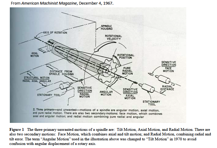

There are three basic spatial error motions in spindles: Radial, axial and tilt (Figure 1). We will see later that spindle error motions are also characterized by frequency and by sensitive direction.

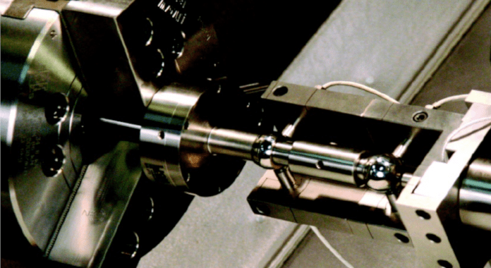

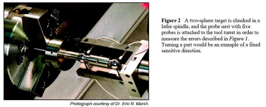

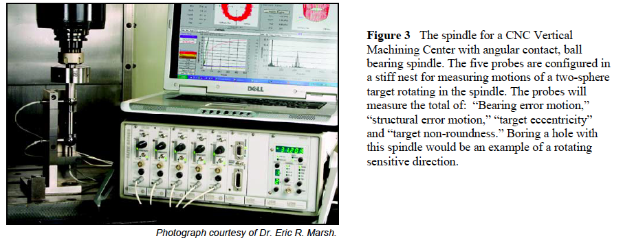

Over the last 50 years, Axis of Rotation Metrology has developed into a standard for characterizing spindles and understanding the capabilities of a machine. The measurement technique involves high bandwidth, non-contact capacitive sensors with nanometer-level resolution. The sensors reference precision pins or spheres that are mounted to the rotating spindle as targets. So with a three-probe system, (two probes arranged radially at 90° from each other, and one axially centered on the axis for X, Y and Z), a point may be referenced in 3-D space. A five-probe system (Figure 2) with two spherical targets may reference two points, and so tilt errors of the spindle may also be known.

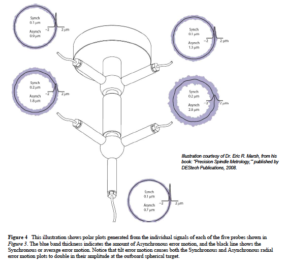

The signals from these five probes each represent a fire hose of information about the spindle’s performance, recording spatial errors and clocking them by frequency. Data can be taken at over 100,000 rpm or less than 1 rpm. The signals may be viewed on an oscilloscope, run though Fast Fourier Transform (FFT) and/or software used to conceptualize the results. (See Figure 3.) Because the spherical artifact is difficult to perfectly align with the axis of rotation, it will have an eccentricity. This eccentricity may be used as a tachometer to phase the data streams with the rotation of the spindle (when an encoder is not conveniently available) and represents an error that is easily subtracted out (like a roundness measuring machine would). This technique allows for phasing a linear data stream (as shown in Figure 7) into polar plots (as seen in Figures 4, 5 and 6.)
What we find in the data, after subtraction of eccentricity, is that some errors are Asynchronous; that is different every time around. If we average the Asynchronous data we have what is called Average Error (per the ASME B89.3.4-1985) now called Synchronous error by the ISO 230-7, and defined as the portion of the total error motion that occurs at integer multiples of the rotational frequency (See Figures 4, 5 and 6.) We will see that asynchronous errors are a main determinant of work-piece surface finish, and synchronous errors are the main determinant of work-piece geometry.
Synchronous (average) error motions
After subtracting out the eccentricity mentioned above, and averaging asynchronous motions, we have what’s called “Synchronous Error Motion.” In most cases this would be considered the spindle error motion. In cases of very high precision spindles, where the 25 or 50 nanometer errors in the target become a significant percentage of the total error motion, another measurement procedure called “Donaldson Reversal” may be employed to subtract out the errors that are in the target.

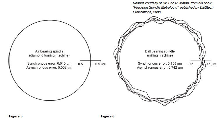

Synchronous (average) error motions are a predictor of how round a hole can be bored or turned with the spindle. So, for example, the synchronous errors of a spindle used to bore bearing seats for other spindles will be the determinate of the roundness of the bearing seats. The roundness of that bearing seat will affect the precision of the manufactured spindle. So the use of spindles with very low Synchronous error motion for boring bearing seats could dramatically improve the precision of the spindles being manufactured. This principle also applies to how round a gear may be made and because synchronous error is an average and gear manufacturing processes often employ fewer revolutions, significant process variations are possible as asynchronous errors have only a few revolutions to averaged over. We will see below that asynchronous errors are often many times larger then synchronous errors.
Synchronous (average) errors are clearly illustrated in plots of air and hydrostatic spindles as the error repeats exactly, every time around. (See Figure 5.) This is, in large part, due to the fact that there is just one rotating element. Error motions in air bearing spindles are often less than 25 nanometers (or one-millionth-of-an-inch). In such a case, Donaldson Reversal would be a necessary methodology as the error motion of the spindle is likely less than the non-roundness of the target.

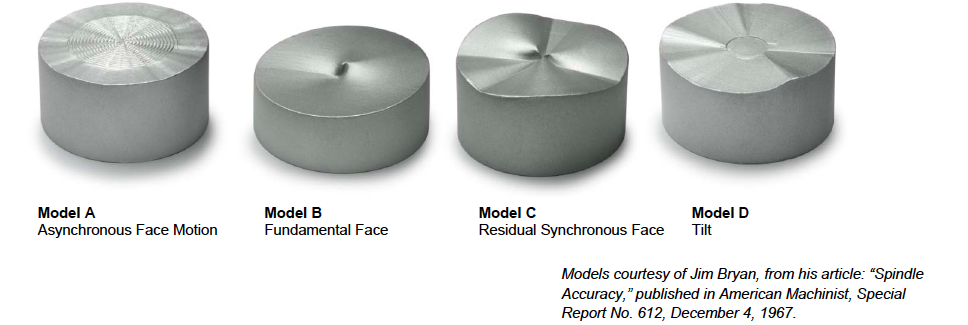

Fundamental synchronous and asynchronous axial motion is measured on the axis of rotation. It is very important when flatness or form at the center of the part is critical. This would be the case in manufacturing optics. The face motions are measured some noted distance from the center, and would be the same as the axial motion in the absence of tilt motion. These errors would be evident on large diameter conical gears. Because they are both measured on the face, both are axial motions and so they cause flatness or profile errors when facing flat or conical parts.
However, fundamental axial face motions will create a part that has the property of circular flatness, that is, the overall surface is not flat, but provides a “flat sealing surface” at any given radius. If you were to put the part on a roundness checker, and measure flatness at some radial distance from the center, you could adjust the part into reading flat at that radius, but the flat surface will not be perfectly square to the axis it was turned on, or the reference surface the part was chucked on. This may be acceptable for a sealing surface, but it would not be a good thing for a bearing surface or gear interface.
The utility of measuring error motions in spindles became evident as hydraulic systems were being applied to military aircraft. Leaky hydraulic fittings were a maintenance headache and a fire hazard. A study by the military to improve the effectiveness of taper seals revealed that residual face motions of spindles making tapered seals would compromise the geometry of the tapers produced and its ability to seal. Bevel gears are very similar to conical seals but as they have larger diameters the amplitude of the errors will be larger.
Residual synchronous face motions are motions left over after the fundamental (the once around) errors are subtracted; they are still synchronous but are at other integer multiples of the rotation frequency. Residual face motions result in parts that are not flat at all, not even circularly flat. Controlling the property of residual face motion is critical whether you are making seals or bearing races and, because tilt is involved, this is especially true with large diameters.

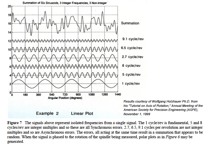

As noted above asynchronous error motions are a predictor of surface finish, and are best illustrated in error motion plots of rolling-element bearings. Because rolling-element bearings have “constituent elements” (rollers, inner race and cages) that are not perfect and have different rotational frequencies, error motions of the spindle appear random. They are not actually random, the determinist view point is that they can be predicted. In rolling-element spindles, these asynchronous motions are generally much larger displacements than the synchronous motions. (See Figures 4, 5 and 6). Over many revolutions, the polar plot develops into a fuzzy band and the thickness of this band represents the asynchronous error motion of the spindle. This is likely to be 100 nanometers in the very best rollingelement spindles; 1000 nanometers (1 micron) in good spindles; and 10 microns or more in 500mm or larger diameter bearings. This is why gear manufactures may see variability in gear teeth profile errors when a large gear is ground or gashed using only a few revolutions.
The linear plot (See Figure 7) shows how the different elements, with their different rotational frequencies, produce what appears to be non-repeatable motion in the summation of their signals (top). The portion of the signal that is asynchronous is the determinant of surface-finish capability. The error motions do repeat though after many revolutions, and can be predicted.. An analogy can be made with the sun, which rises differently each day but is, after many rotations, repeatable.

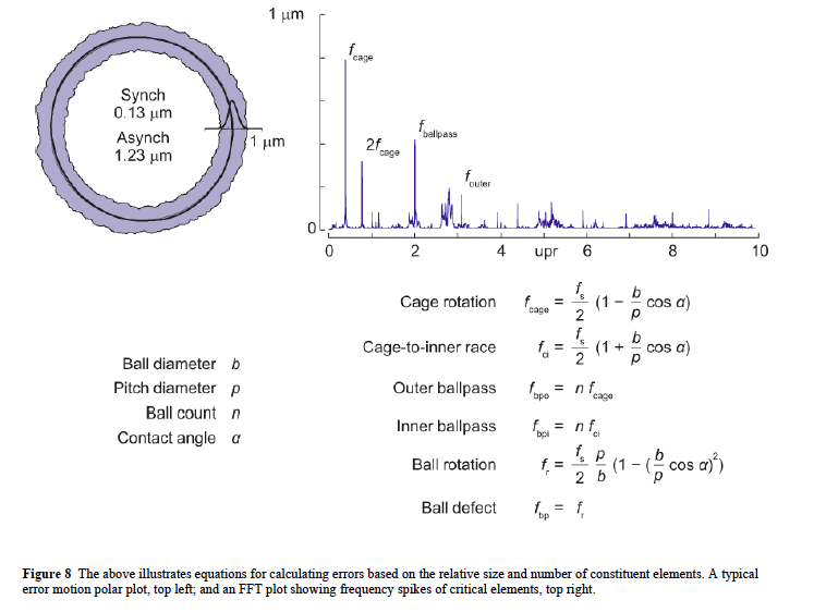

Figure 7 also shows that the error-motion signal may be decomposed into frequency components, and that doing so can result in a better understanding of the factors causing observed motion. For rolling element bearings, characteristic frequency equations can predict error motion encountered during spindle rotation that are a function of the geometry of the bearing components (diameter of races, number of rolling elements, diameter of rolling elements, etc.).
The Fast Fourier Transform (FFT) is the most common method for separating the frequency components of a signal. An example of this can be seen in Figure 8 for a single row, deep-groove bearing. Note that the cage, ball pass and outer race frequency spikes are identified in the chart.

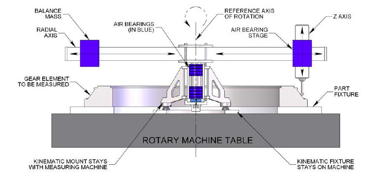

Air Bearing Spindles as a Metrology Reference
Air bearing spindles are an excellent metrology standard, they are the basis of most roundness measuring machines. The large gear industry may do well to consider metrology tools based on air bearing spindles that may be brought to the part rather than taking the parts to a very large and expensive Cartesian metrology machines (conventional CMMs). The design below contemplates a light weight, mobile measuring system that would index to be co-axial automatically to within a few microns of a machine tool work table via a kinematic mount. The measuring machine would then act just like typical CMMs with regard to software and probe systems. The part could be measured as machined and again after the unclamping from the fixture to understand chucking distortions and avoid trips back and forth between the machine tool and the CMM. The measuring machine could be moved from machine tool to machine tool or to a dedicated measuring station. In some cases it could attached directly to the part to be measured. This when manufacturing large round parts this would be a powerful way to increase measuring flexibility, measuring precision and reduce costs at the same time.
