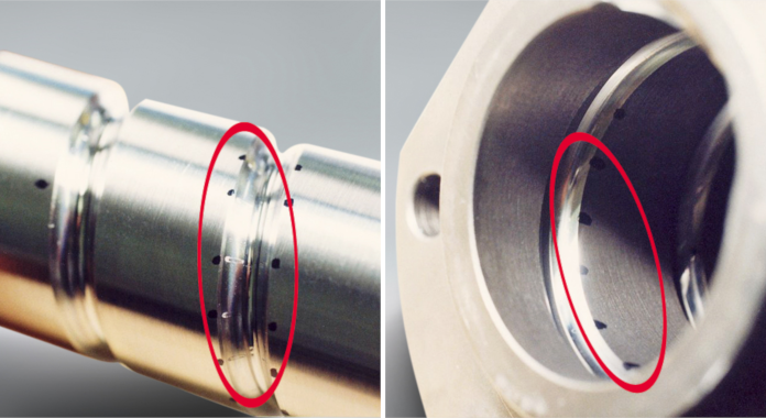

Indentation 1
Part: Screw shaft
Symptom: Indentations on a raceway
Cause: Indentations caused by excessive impact load or by contamination or intruded metal particles
Indentation 2
Part: Screw shaft
