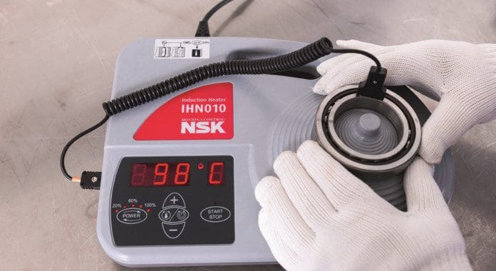

The mounting of bearings is a practice that requires the correct knowledge and skills. Historically, this task has seen maintenance personnel make a certain amount of mistakes, which consequently have reduced the lifespan of bearings. Further factors compromising service life include a failure to keep the bearings clean, not respecting the recommended clearances between the bearing rings and the shaft, and failing to use professional mounting tools. However, according to global bearing manufacturer NSK, these errors can easily be avoided.

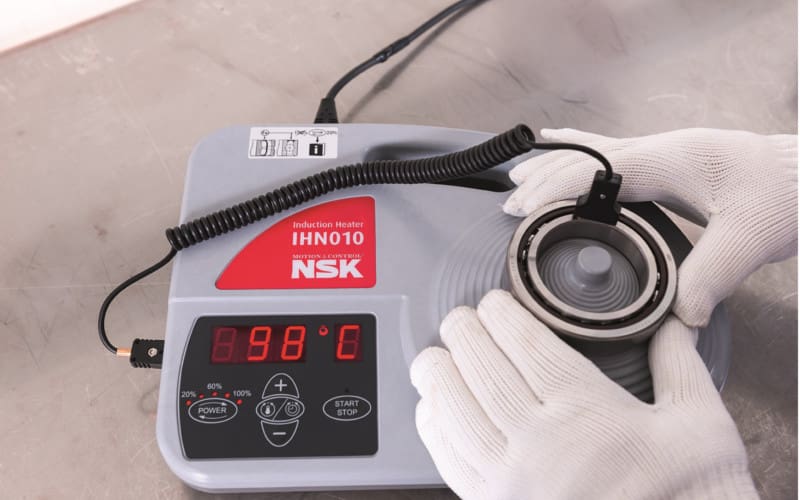

Installation using the correct tool – here an induction heater – makes an important contribution to the proper functioning of bearings over a long period of time

In addition to the training provision, as part of its AIP+ (Added Value Programme) service package, NSK offers tools for mounting bearings in a professional manner. These special tools are needed to apply the correct force necessary to press the bearing ring into place. In the case of cold mounting, it is important to ensure that mounting forces are never transferred through the rolling elements of the bearing, otherwise damage may occur, not just to the rolling elements, but also the raceways.

Even when performing hot mounting with hydraulic tools and induction heaters, damage can still occur to the bearings if the selected tools are not suitable for the application or used incorrectly. Such a scenario can lead to dents in the raceways, deformed seals, damage to adjacent components and even cracks in the bearing rings.
