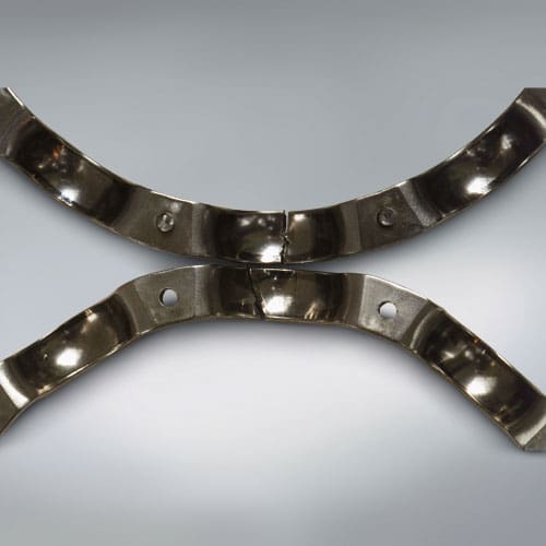

Cage Damage 1
Part: Cage of a deep groove ball bearing
Symptom: Fracture of pressed-steel cage pocket
