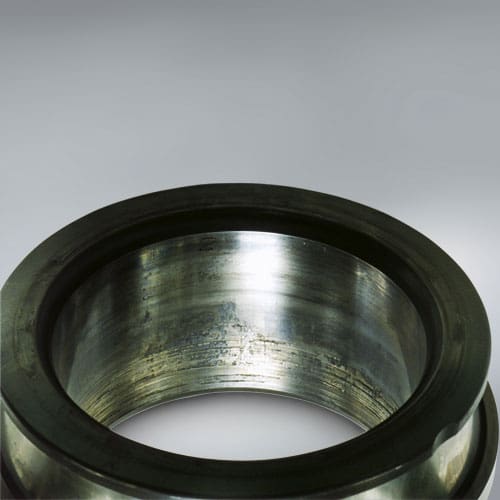

Creep 1
Part: Inner ring of a spherical roller bearing
Symptom: Creep accompanied by Scoring of bore surface
Cause: Insufficient interference

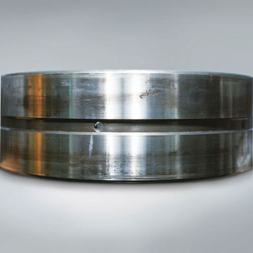

Creep 2
Part: Outer ring of a spherical roller bearing
Symptom: Creep over entire circumference of outside surface
Cause: Loose fit between outer ring and housing
