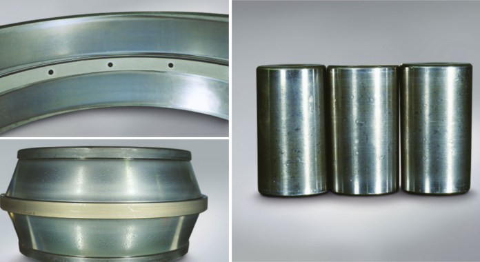

Denting 1
Part: Inner ring of a double-row tapered roller bearing
Symptom: Frosted raceway surface
Cause: Debris caught in the surface
Denting 2
Part: Outer ring of a double-row tapered roller bearing
Symptom: Indentations on raceway surface
Denting 3
Part: Inner ring of a tapered roller bearing
Symptom: Small and large indentations occur over entire raceway surface
Denting 4
Part: Tapered rollers of damage “Denting 3“
Symptom: Small and large indentations occur over the rolling surface
