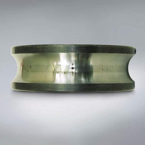

False Brinelling 1
Part: Inner ring of a deep groove ball bearing
Symptom: False brinelling on the raceway
Cause: Vibration from an external source while stationary

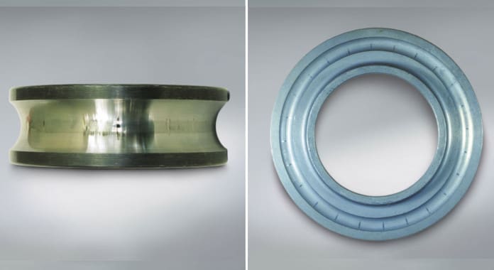

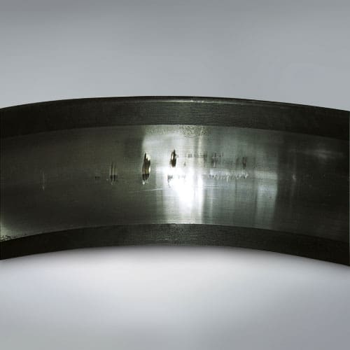

False Brinelling 2
Part: Outer ring of damage “False Brinelling 1”

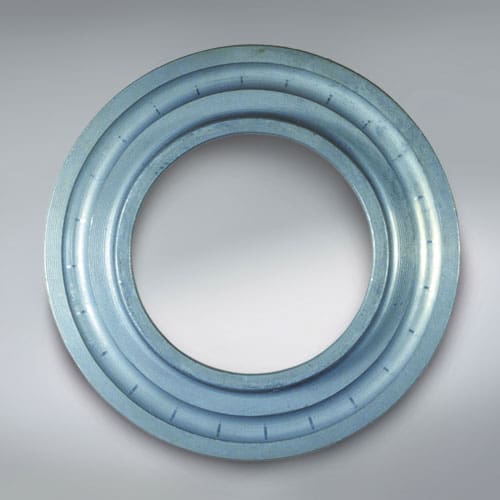

False Brinelling 3
Part: Outer ring of a thrust ball bearing
Symptom: False brinelling of raceway surface at ball pitch
Cause: Repeated vibration with a small oscillating angle

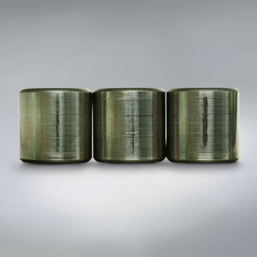

False Brinelling 4
Part: Rollers of a cylindrical roller bearing
Symptom: False brinelling on rolling surface
