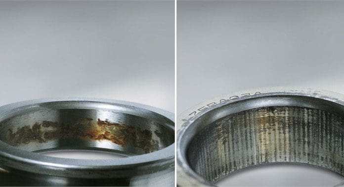

Wear occurs due to repeated sliding between the two surfaces.
Fretting occurs at fitting surface and also at contact area between raceway ring and rolling elements.
Fretting corrosion is another term used to describe the reddish brown or black worn particles.
Possible Causes
  • Poor lubrication
  • Vibration with a small amplitude
  • Insufficient interference
Countermeasures
  • Use a proper lubricant
  • Apply a preload
  • Check the interference fit
  • Apply a film of lubricant to the fitting surface

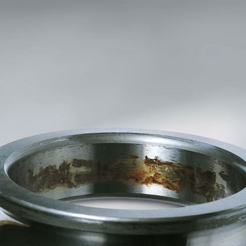

Fretting 1
Part: Inner ring of a deep groove ball bearing
Symptom: Fretting on the bore surface
Cause: Vibration

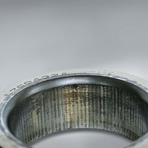

Fretting 2
Part: Inner ring of an angular contact ball bearing
Symptom: Fretting over entire circumference of bore surface
Cause: Insufficient interference fit

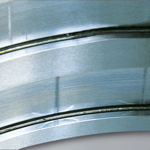

Fretting 3
Part: Outer ring of a double-row cylindrical roller bearing
Symptom: Fretting on the raceway surface at roller pitch intervals
