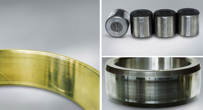

Mounting Flaws 1
Part: Inner ring of a cylindrical roller bearing
Symptom: Axial scratches on raceway surface
Cause: Inclination of inner and outer rings during mounting

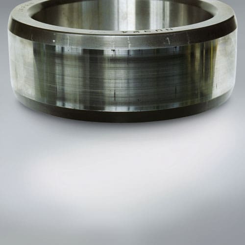

Mounting Flaws 2
Part: Outer ring of a double-row cylindrical roller bearing
Symptom: Axial scratches at roller pitch intervals on raceway surface
Mounting Flaws 3
Part: Rollers of a cylindrical roller bearing
Symptom: Axial scratches on rolling surface
