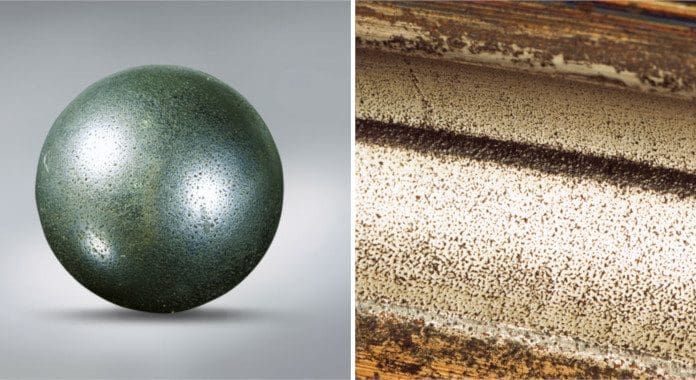

Pitting 1
Part: Outer ring of a slewing bearing
Symptom: Pitting on the raceway surface
Cause: Rust
Pitting 2
Part: Ball of damage “Pitting 1”
Symptom: Pitting on the rolling element surface
