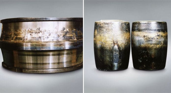

Seizure 1
Part: Inner ring of a spherical roller bearing
Symptom: Raceway is discolored and melted. Worn particles from the cage were rolled and attached to the raceway.
Cause: Insufficient lubrication
Seizure 2
Part: Convex rollers of damage “Seizure 1”
Symptom: Discoloration and melting of roller rolling surface, adhesion of worn particles from cage
