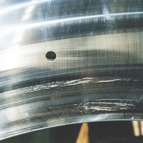

Smearing 5
Part: Inner ring of a spherical roller bearing
Symptom: Partial Smearing around circumference of raceway surface
Cause: Poor lubrication
Smearing 6
Part: Outer ring of damage “Smearing 5”

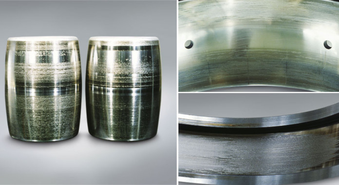

Smearing 7
Part: Convex rollers of damage “Smearing 5”
Symptom: Smearing of rolling surfaces
