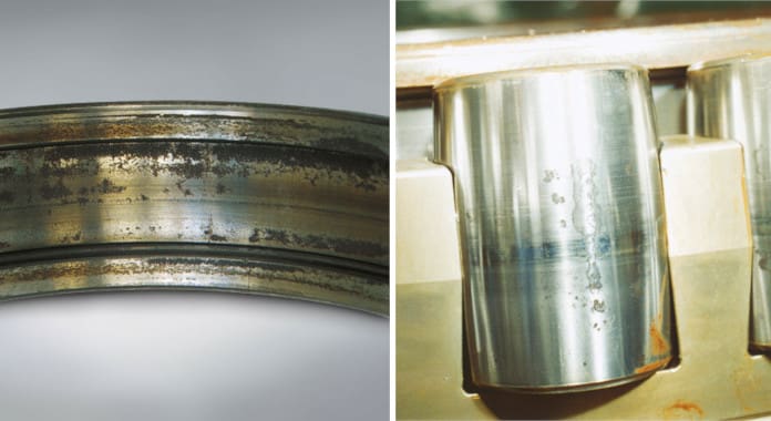

Rust and Corrosion 1
Part: Outer ring of a cylindrical roller bearing
Symptom: Rust on the rib face and raceway surface
Cause: Water entry

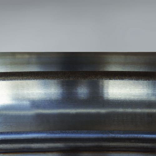

Rust and Corrosion 2
Part: Outer ring of a slewing ring
Symptom: Rust on raceway surface at ball pitch intervals
Cause: Moisture condensation during stationary periods

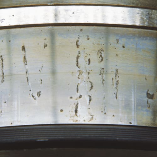

Rust and Corrosion 3
Part: Inner ring of a spherical roller bearing
Symptom: Rust on raceway surface at roller pitch intervals
Cause: Entry of water into lubricant

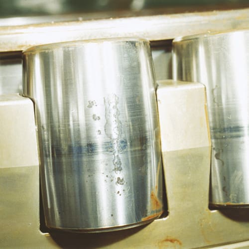

Rust and Corrosion 4
Part: Rollers of a spherical roller bearing
Symptom: Pit-shaped rust on rolling contact surface. Corroded portions.
Cause: Moisture condensation during storage
