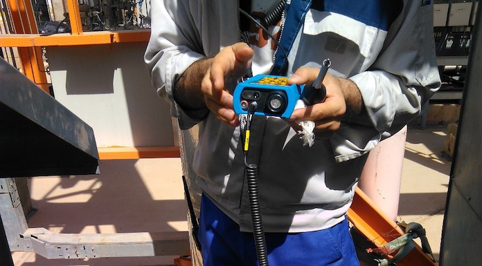

Figure 1 – Collecting ultrasound data with SDT270 while replenishing lubricant

To drive home this point, Haris Trobradovic, one of SDT’s many globe-trotting corporate trainers recently delivered training to a petrochemical facility in the Middle East.
“During the training, we performed measurement practice on several machines (Figure 1). One of the machines was a fan, scheduled for re-lubrication in a few days.” recalls Haris. “The customer’s standard greasing practice is to follow manufacturer’s recommendations for both interval and amount. In other words, they grease on a time-based schedule and trust the motor manufacturer to guide on quantity.”
Trobradovic used the opportunity and performed re-greasing exactly as recommended by the OEM, even though the Condition Monitoring team had a different opinion. Their ultrasound data did not indicate any need for grease replenishment. The Condition Monitoring team members are strong advocates for on-condition lubrication and doing away with time-based.
