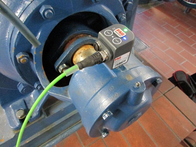

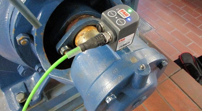

The two centrifugal water pumps are fitted with two SmartQB sensors (for measuring vibration and temperature) and connected via one FAG SmartQB.

The FAG SmartQB early warning system comprises of a FAG SmartQB sensor unit, a cube-shaped housing with touchscreen display, and a cable for power and data transmission (Power-over-Ethernet).
Schaeffler and its local partner KSA recommended the FAG SmartQB system. As part of a pilot project, two centrifugal pumps were fitted with two SmartQB sensors (for measuring vibration and temperature) and connected via one FAG SmartQB. In the event of any bearing defects, the FAG SmartLamp installed next to the FAG SmartQB illuminates red and the system generates an alarm message. With only two additional clicks on the touchscreen display, the maintenance technician can view more detailed information about the fault and is provided with specific recommended actions.
After a short period of time, the system has proven itself. Due to the information provided by FAG SmartQB and its automatic fault assessment feature that gives an early warning of the onset of any bearing damage, maintenance personnel are now able to react quickly and in a targeted manner.
Both bearings in the 8-stage centrifugal pump were replaced in a very short time, which prevented severe damage to the facility. Unplanned downtime of up to several weeks combined with significant damage amounting to several thousands of euros was therefore prevented.
