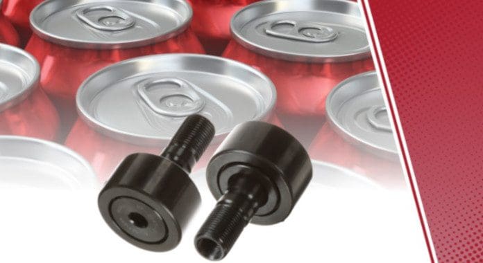

The McGill® CF-2965-2 bearings feature:
- Cage separated needle rollers balance the need for operating speed and load rating.
- Integral steel flange prevents disassembly in thrust load situations.
- Heavy section outer helps support radial loading and provide proper rolling elements.
- LUBRI-DISC® bearing seals help retain grease and keep out contaminants, as well as separate internal sliding contact resulting in lower operating temepratures.
- Zone hardened raceways provide high load ratings, and the ductile stem gives strength for absorbing shocks.
- Hardened endplates resists wear from incidental contact with outer rollers.
