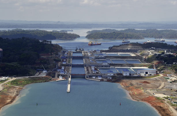

The newest of what are now three channels in the Panama Canal eliminates a bottleneck for global commercial shipping. Schaeffler has supplied more than 3,400 rolling bearings for the lock technology and for water management.
The locks are necessary both on the Atlantic and on the Pacific side so that ships can overcome a difference in height of 26 meters and pass through the interior of the country. Components made by Schaeffler play a key role in the operation of the lock gates. (Image: Schaeffler)
After a nine-year construction period, the new, third channel of the Panama Canal opened yesterday (2016-06-26). Starting immediately, ships with a maximum length of 366 meters (984 feet) and a width of around 50 meters (164 feet) can travel this shortcut between the Atlantic and the Pacific Oceans. Until now, the passage was restricted to ships that were no more than 290 meters (951 feet) long and 32 meters (105 feet) wide. Bearing solutions from Schaeffler keep lock gates and valves moving.

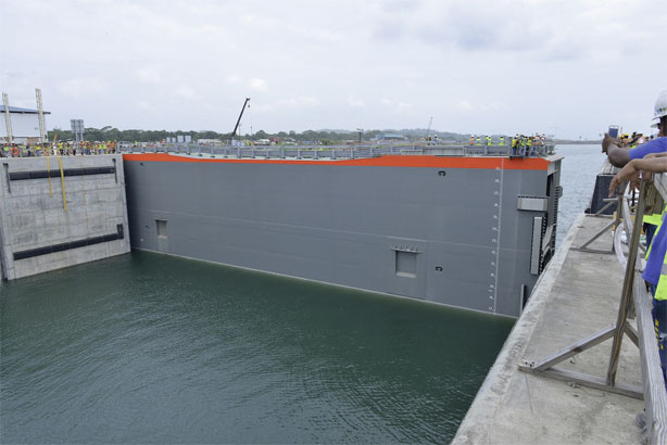

Components made by Schaeffler play a key role in the operation of the lock gates. The locks are necessary both on the Atlantic and on the Pacific side so that ships can overcome a difference in height of 26 meters and pass through the interior of the country. This is achieved by three consecutive locks that are flooded with water from adjoining reservoirs. The lock gates are made of reinforced concrete and have enormous dimensions: They are 50 meters (164 feet) wide, 30 meters (98 feet) high and 10 meters (33 feet) thick. For safety reasons, two gates have been installed for each barrage that open to the side. The mechanism for opening and closing the gates was developed by Italian engineering company Cimolai Technology. To open and close the gate, each has two main drive units that drive a cable winch. The drums of the steel cable winches are supported by spherical roller bearings made by Schaeffler. Since very high torques of up to 330,000 Nm are required to move the gates, there is also a gearbox on each that increases the torque of the electric motors by almost 280 times. The gearboxes developed by PIV Drives, a company owned by the Brevini Group, are equipped exclusively with tapered, spherical and cylindrical roller bearings made by Schaeffler. Most of the bearings have been coated with Schaeffler’s Triondur C to prevent wear and ensure their operation for 35 years.
The lock gates are made of reinforced concrete and have enormous dimensions: They are 50 meters (164 feet) wide, 30 meters (98 feet) high and 10 meters (33 feet) thick. (Image: Panama Canal Authority)
Both at the top and at the bottom of the reservoirs, two so-called “carriages” guide the gates that weigh 3,100 tons. Here guide pulleys are used that must be able to withstand not only the gates‘ dead weight but also the pressure of 430 million liters of water per reservoir. The guide pulleys are equipped with spherical roller bearings supplied by Schaeffler.

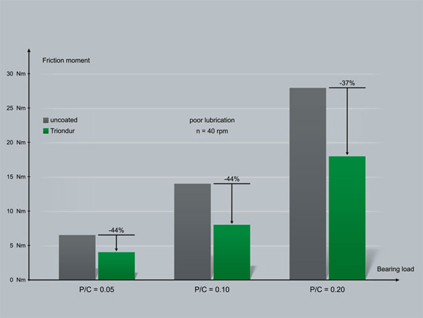

Most of the gearbox bearings have been coated with Schaeffler’s Triondur C to prevent wear and ensure their operation for 35 years. (Image: Schaeffler)

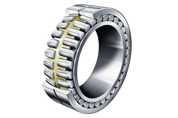

Schaeffler was able to develop some solutions based on standard products despite the tough requirements for technology in the expansion of the Panama Canal. The guide pulleys of the gates that weigh 3,100 tons are equipped with spherical roller bearings supplied by Schaeffler. (Image: Schaeffler)
