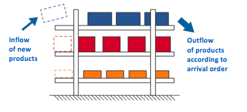

Inventory control
- For inventory control purposes, we recommend using a first in, first out (FIFO) inventory policy.

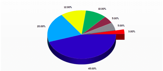

Bearing failure causes
Bearings are machine elements that need to be stored and handled with necessary care in order to ensure their maximum performance.
Bearings that are not stored in their original packaging need to be well protected against corrosion and contaminants.
