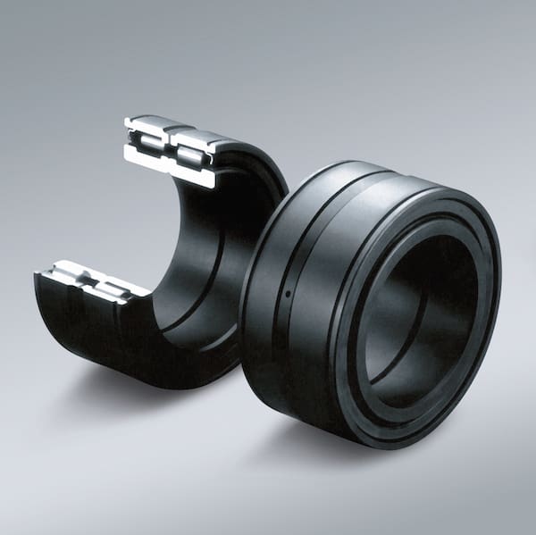

With the high load and low speed of the application in mind, it was recommended that the steel plant switch to NSK´s multi-row sealed cylindrical roller bearings (crane sheave bearings). As the name implies, this bearing type is often employed in crane sheaves found in quarries, ports and construction sites. However, the high load capacity and advanced sealing of crane sheave bearings means they are also ideal for use in the demanding conditions that prevail in steelmaking environments.
On the steel strip annealing line, NSK´s machine design support prompted a revision to the housing so it could better accommodate the crane sheave bearing unit. Importantly for the steelmaker, NSK´s full complement cylindrical roller bearings offer an advanced system of contact seals that minimises grease leakage and increases resistance to the entry of water and other foreign substances. In addition, the ability to provide reliable life in arduous environments is enhanced by machined holes that feature on the inner and outer rings of the bearings to allow the replenishment of lithium grease in situ. Re-lubrication holes facilitate easy maintenance and grease replenishment, while the provision of a phosphate surface treatment to improve corrosion resistance is a further benefit.
