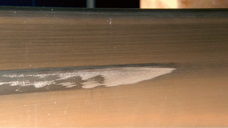

                         Arrow or diamond-shaped smears in the raceways of a bearing without black oxide finish

Rolling bearings operating in low-load situations and bearings that are subjected to rapid speed changes during operation can be susceptible to adhesive wear (slippage damage and smearing). Under these conditions, slippage occurs at the contact area between the rolling elements and most commonly the inner ring raceway, especially when the difference between the rolling speeds between raceway and rolling elements is very high. The resulting slippage, which mainly takes place where the rolling elements enter the load zone, causes smearing. This, in turn, causes lasting damage to the rolling element and raceway’s surfaces and material structure. The operating characteristics of the bearing consequently deteriorate quickly and a premature failure of the bearing is not unusual. This type of damage often occurs where lubrication is insufficient or an unsuitable lubricant is used.

Cylindrical roller bearings with a bore diameter smaller than 560 mm are designed to operate at an operating load of approx. 1 percent of their dynamic load carrying capacity and with a rotation speed of up to 1200 rpm. Despite design measures to reduce the number of rolling elements and thus the load carrying capacity, the formation of the characteristic arrow or diamond shaped smearing marks (Fig. 1) in the raceway and corresponding damage to the rolling elements (Fig. 2) cannot be entirely avoided. NKE resolved this issue effectively by using rolling elements with a black oxide finish and introducing a lubricant chosen specifically for this application.

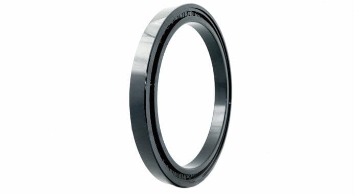

                                        Full complement cylindrical roller bearing NCF1880-SQ94D from NKE

Black oxide finished bearings from NKE
Black oxide finishing is already an established method in other industries. NKE uses this technology to further improve the technical properties of rolling bearings. The method has proven itself in practice especially with full complement cylindrical roller bearings (Fig. 3), but other types of rolling bearing are also black oxide finished, depending on the application. NKE offers a large number of black oxide finished rolling bearings. At NKE, this finish is used especially for cylindrical roller bearings, which then carry the suffix SQ94. The most common variants are SQ94B (rolling elements black oxide finished) and SQ94-D (all bearing components except for the cage black oxide finished).
