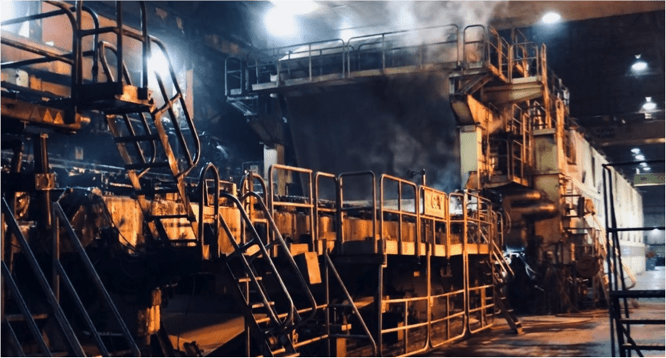

Implementation of an ultrasonic lubrication program in a paper mill to acoustically grease bearings right.
The LUBExpert system has allowed the maintenance team to shift away from unreliable calendar-based lubrication to on-condition lubrication with instant feedback to the technician as each bearing is greased.
Dryer section felt rolls – previously greased on a time-based schedule delivering 40 grams of grease every 4 weeks before the ultrasound program was implemented.
Ultrasonic greasing program started; first dryer felt roll greased from an RMS of 14.1 dBμV down to 12.2 dBμV after delivering only 20 grams of grease.
