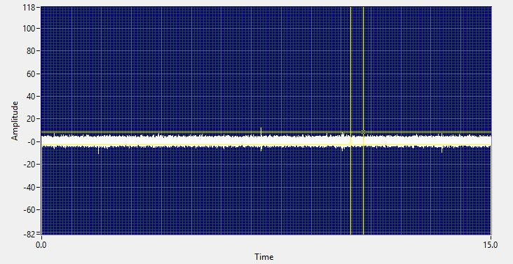

Sound Spectrum of a “good” bearing. Very uniform and no changes in amplitude. ©️ UE Systems

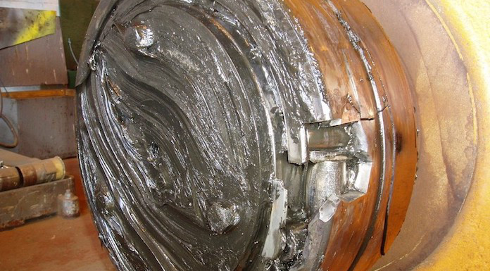

An ultrasonic instrument was used to inspect all bearings – almost all of them presented a nice and smooth sound and a 0dB reading, except for one. On one of the bearings from this set, the ultrasonic instrument was displaying 2dB instead of 0. Also, the sound heard from the headphones was different: it was not smooth as in the other bearings and it presented a repetitive “knocking” sound. This gave the inspector an indication that something might have been wrong with this specific bearing.

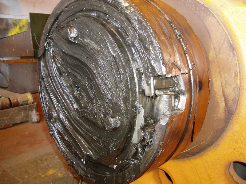

After the results from the ultrasonic inspection, a grease sample was taken to confirm if there was any damage on the bearing – in which case the grease sample would show metal contamination. The results from the grease analysis showed indeed the presence of metal particles, confirming the damage as indicated by the ultrasound instrument.
The next step was naturally scheduling an outage to replace the bearing, which was in a very bad condition as it can be seen in the images. Part of the outer race came away as it was opened. It was also noticeable that one of the rollers had moved 90 degrees. The cage had been totally damaged too.

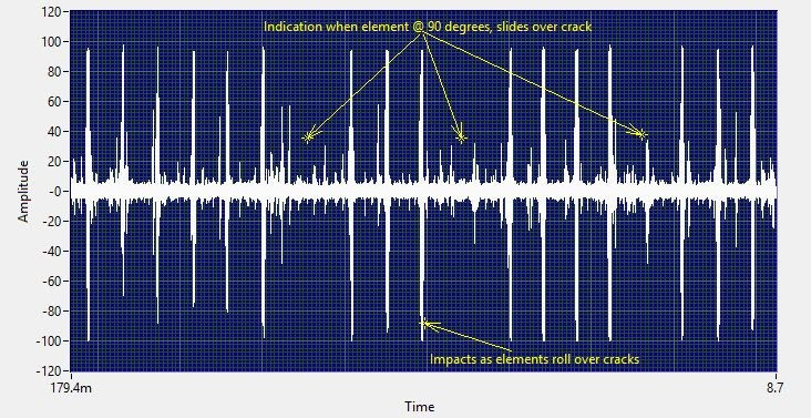

For slow speed bearings, one must rely on the sound quality and the sound pattern. For this, it is necessary to use an ultrasonic instrument with sound recording capabilities, like the Ultraprobe 15000, and then analyse the sound file on a sound spectrum analysis software like the Spectralyzer from UE Systems. Then, maintenance professionals can simply record the sound produced by a slow-speed bearing, load the file in Spectralyzer and analyse it in the Time Series view.
The spectrum analysis of this oven motor bearing shows clearly where the roller at 90 degrees hits the crack as the knock stops briefly. Thus, the sound pattern indicates already an existing problem, being the most reliable source of information when determining the condition of a slow-speed bearing using ultrasound.
On the other hand, the spectrum of a recorded sound from one of the “good” bearings shows a very different picture: a very uniform spectrum with almost no changes in the amplitude.
