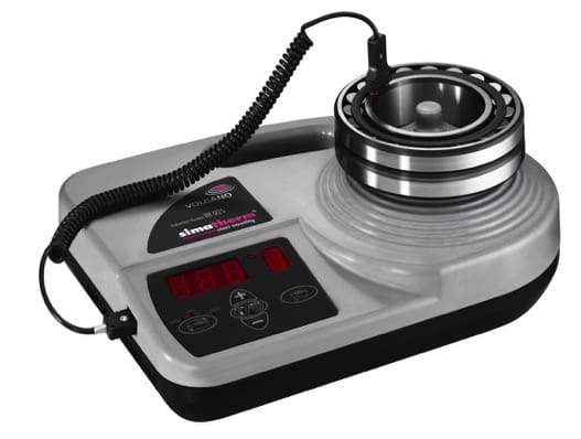

Out of round housing or shaft localized overloading can cause an abnormal wear on surfaces and retainer pockets. Early fatigue occurs in these areas. To prevent all these from happening a proper inspection is needed before installation. Use correct tools (e.g. induction heaters) and follow the installation instructions provided by manufacturers.

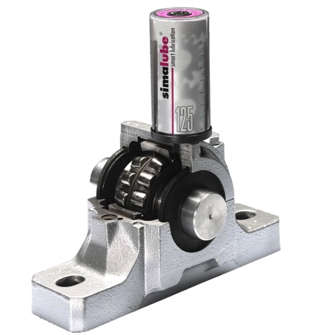

Improper Bearing Lubrication: This is one of the major causes of bearing failures. Every maintenance mechanic has to follow the rule of five rights of lubrication.
1. Right lubricant: Lots of people think “grease is a grease”, it is wrong. You need to make sure that the lubrication you are applying is compatible with the lubrication that the bearing already has and also be sure that it is a right lubricant for the application.
2. Right quantity: When greasing the bearings, lots of people are pumping the grease till they see the grease coming out, then they stop. This is wrong. This is called overgreasing. There are many hard to reach areas where bearings never get greased.
3. Right time: It is important to know how often each lubrication point must be greased and have a good lubrication schedule in a place.
4. Right place: Adding the wrong grease to a lubrication point is not uncommon. This situation will usually go undetected until a problem occurs. All lubrication points should be properly labeled as to the lubricant to be added.
5. Right method: It is very important to make sure that lubrication points are properly cleaned. Make sure the contaminants will not get into the lubrication or in the bearings.
If you take into consideration all the five rights, your bearings should last much longer. Make sure you label all your lubricants and lubrication points. The lubrication schedule is easy for everyone to understand. Consider using automatic lubricators.
