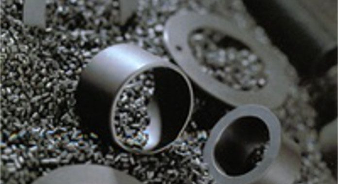

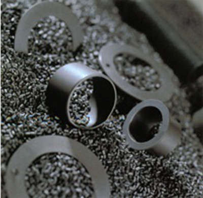

There are so many options for bearings and bushings on the market today, including metal, polymer, and composite.
In this blog post, we are going to take a quick look at composite bearings, including what exactly qualifies as a composite bearing and how their performance compares to other types of bearings and bushings.
Types of Composite Bushings and Bearings
Exactly what is meant by the term “composite bushing” can vary according to manufacturer. For example, there are composite bushing designs that combine a steel backing with a sintered bronze layer covered with a polymer lining such as PTFE. There is also a more classic approach to composite bushings that combines a polymer resin with glass fibers, often filament wound, and a PTFE lining to reduce friction and provide lubrication.
