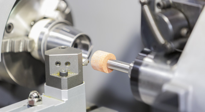

In the grinding process, the drives of the grinding spindles and work-head dresser have to run with extreme smoothness and precision (Photo: sorapolujjin / Fotolia)
